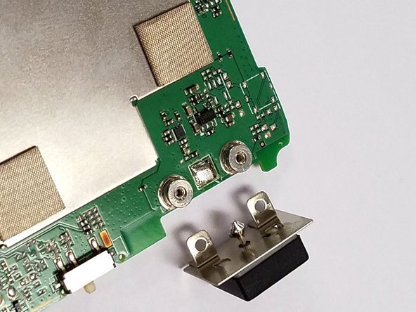

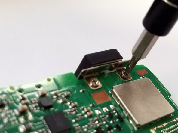

    • Remove the two 2.4mm Phillips #00 screws that hold the antenna to the motherboard.
  7. Magellan RoadMate 5120-LMTX Antenna Replacement: crwdns2935265:07crwdnd2935265:01crwdnd2935265:03crwdne2935265:0 Magellan RoadMate 5120-LMTX Antenna Replacement: crwdns2935265:07crwdnd2935265:02crwdnd2935265:03crwdne2935265:0 Magellan RoadMate 5120-LMTX Antenna Replacement: crwdns2935265:07crwdnd2935265:03crwdnd2935265:03crwdne2935265:0

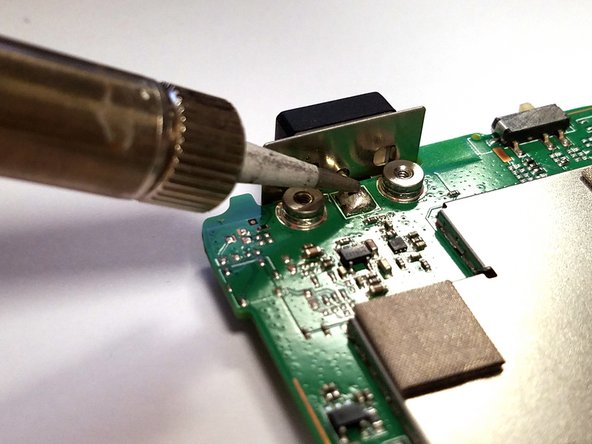

    • Flip the motherboard over and locate the soldered antenna connection.
    • Melt the existing solder with the tip of your soldering iron while gently pulling on the antenna. The antenna should come off easily.
    • When reassembling your device, attach your new antenna to the motherboard using the two 2.4mm Phillips #00 screws before soldering. This will help to align the parts properly and make them easier to solder.
To reassemble your device, follow all instructions before soldering step in reverse order.
