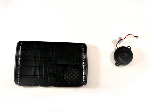

  5. Magellan RoadMate 2120T-LM Speaker Replacement, Speaker: crwdns2935265:05crwdnd2935265:01crwdnd2935265:02crwdne2935265:0 Magellan RoadMate 2120T-LM Speaker Replacement, Speaker: crwdns2935265:05crwdnd2935265:02crwdnd2935265:02crwdne2935265:0
    • Locate the internal speaker just above the battery
    • Remove the two 3 mm Phillips #1 screws.
