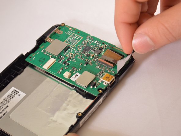

  6. Magellan RoadMate 2120T-LM Motherboard Replacement: crwdns2935265:06crwdnd2935265:01crwdnd2935265:02crwdne2935265:0 Magellan RoadMate 2120T-LM Motherboard Replacement: crwdns2935265:06crwdnd2935265:02crwdnd2935265:02crwdne2935265:0
    • Remove black tape covering connection ribbon for touch-screen

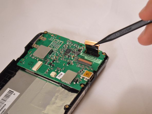

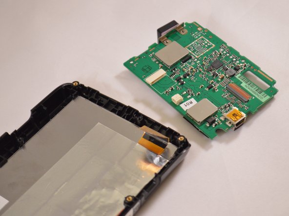

  7. Magellan RoadMate 2120T-LM Motherboard Replacement: crwdns2935265:07crwdnd2935265:01crwdnd2935265:03crwdne2935265:0 Magellan RoadMate 2120T-LM Motherboard Replacement: crwdns2935265:07crwdnd2935265:02crwdnd2935265:03crwdne2935265:0 Magellan RoadMate 2120T-LM Motherboard Replacement: crwdns2935265:07crwdnd2935265:03crwdnd2935265:03crwdne2935265:0
    • Pull up on the brown tab holding down the ribbon.
    • In this picture the brown tab has already been lifted.
    • Lift up on the motherboard and remove it from device.
