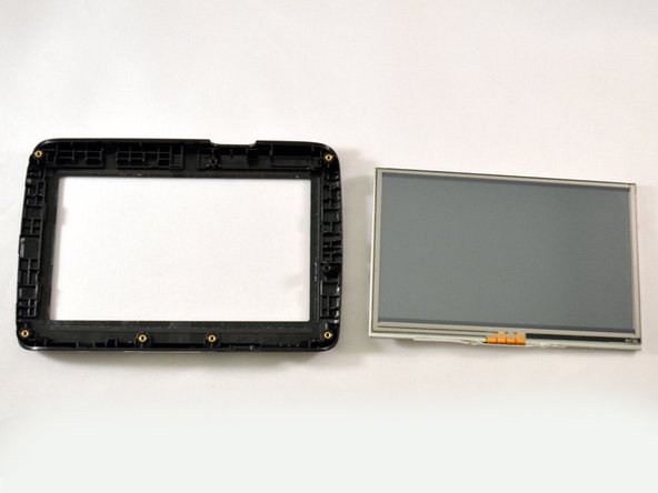

  8. Magellan RoadMate 2120T-LM Display Assembly Replacement, Display Assembly: crwdns2935265:08crwdnd2935265:01crwdnd2935265:02crwdne2935265:0 Magellan RoadMate 2120T-LM Display Assembly Replacement, Display Assembly: crwdns2935265:08crwdnd2935265:02crwdnd2935265:02crwdne2935265:0
    • Pry back on the plastic shell surrounding the touchscreen and remove the screen.
