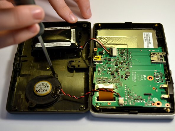

  6. Magellan RoadMate 1440 Speaker Replacement, Battery: crwdns2935265:06crwdnd2935265:01crwdnd2935265:02crwdne2935265:0 Magellan RoadMate 1440 Speaker Replacement, Battery: crwdns2935265:06crwdnd2935265:02crwdnd2935265:02crwdne2935265:0
    • Use the black spudger to break the seal between the adhesive and battery. Use the same spudger to continue to pry the battery from the backing
    • This may be a little tough to separate the battery and the adhesive
  7. Magellan RoadMate 1440 Speaker Replacement: crwdns2935265:07crwdnd2935265:01crwdnd2935265:02crwdne2935265:0 Magellan RoadMate 1440 Speaker Replacement: crwdns2935265:07crwdnd2935265:02crwdnd2935265:02crwdne2935265:0
    • Lift the battery from the device
    • Once the battery is free from the adhesive, remove the piece of tape with a pair of tweezers that is covering the connection of the battery to the motherboard.
  8. Magellan RoadMate 1440 Speaker Replacement: crwdns2935265:08crwdnd2935265:01crwdnd2935265:02crwdne2935265:0 Magellan RoadMate 1440 Speaker Replacement: crwdns2935265:08crwdnd2935265:02crwdnd2935265:02crwdne2935265:0
    • Unplug the battery from the mother board by pulling back the clips and pulling the wires away from the motherboards receptacle
    • It is important for your and the device's safety to remove the battery before continuing with any other part removals.
    • It is not necessary to separate the red and white wires from the battery. A replacement battery pack will come with similar wires already attached.

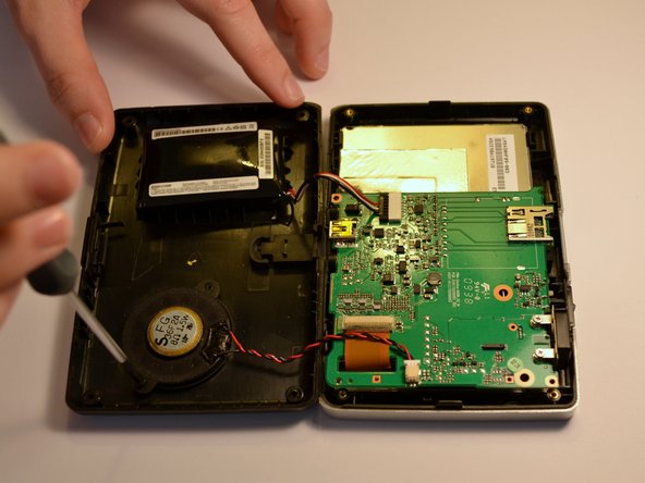

  9. Magellan RoadMate 1440 Speaker Replacement, Speaker: crwdns2935265:09crwdnd2935265:01crwdnd2935265:03crwdne2935265:0 Magellan RoadMate 1440 Speaker Replacement, Speaker: crwdns2935265:09crwdnd2935265:02crwdnd2935265:03crwdne2935265:0 Magellan RoadMate 1440 Speaker Replacement, Speaker: crwdns2935265:09crwdnd2935265:03crwdnd2935265:03crwdne2935265:0
    • After the back has been removed, locate each of the screws securing the speaker to the inside of the back cover.
    • Use a Phillips #0 screwdriver to remove the two 3.8mm Phillips #0 screws.

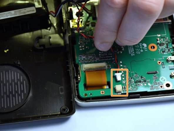

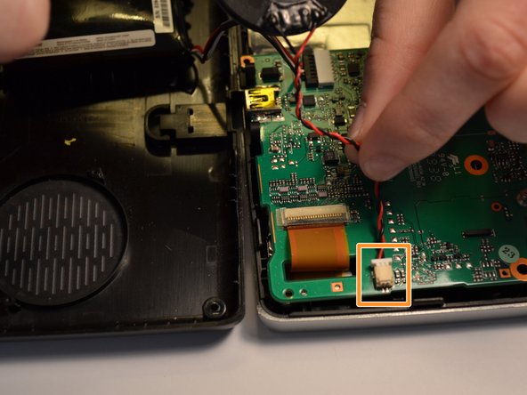

  10. Magellan RoadMate 1440 Speaker Replacement: crwdns2935265:010crwdnd2935265:01crwdnd2935265:03crwdne2935265:0 Magellan RoadMate 1440 Speaker Replacement: crwdns2935265:010crwdnd2935265:02crwdnd2935265:03crwdne2935265:0 Magellan RoadMate 1440 Speaker Replacement: crwdns2935265:010crwdnd2935265:03crwdnd2935265:03crwdne2935265:0
    • The speaker is connected to the motherboard by a few wires
    • Gently remove the connector from the motherboard to completely remove the speaker.
