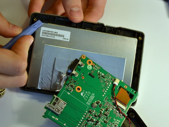

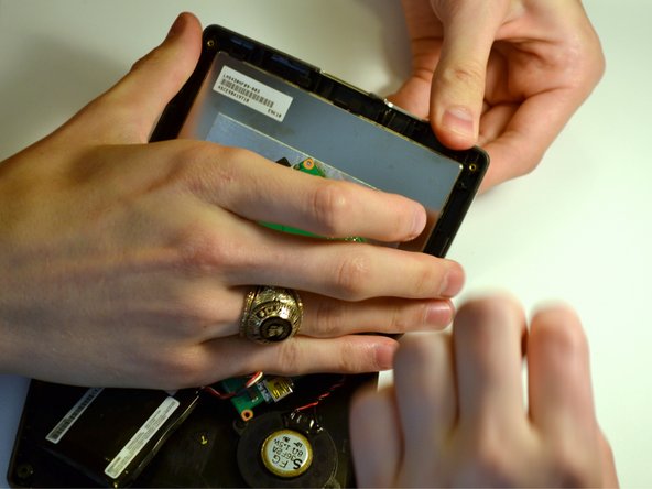

  10. Magellan RoadMate 1440 Screen Replacement: crwdns2935265:010crwdnd2935265:01crwdnd2935265:03crwdne2935265:0 Magellan RoadMate 1440 Screen Replacement: crwdns2935265:010crwdnd2935265:02crwdnd2935265:03crwdne2935265:0 Magellan RoadMate 1440 Screen Replacement: crwdns2935265:010crwdnd2935265:03crwdnd2935265:03crwdne2935265:0
    • It may be necessary to get help from a friend to hold the device stable while removing the screen.
    • Using two hands, pull back the tabs holding the screen in place.
    • Use a spudger to help use leverage to remove the screen, if necessary

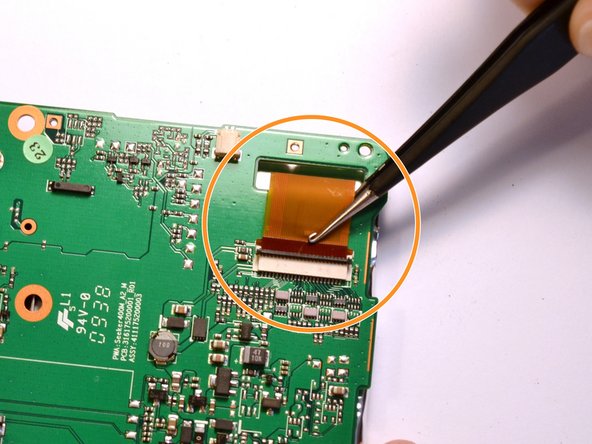

  11. Magellan RoadMate 1440 Screen Replacement: crwdns2935265:011crwdnd2935265:01crwdnd2935265:02crwdne2935265:0 Magellan RoadMate 1440 Screen Replacement: crwdns2935265:011crwdnd2935265:02crwdnd2935265:02crwdne2935265:0
    • Raise the switch locking the ribbon cable in place.
    • Using twesers, pull the ribbon cable from the socket.

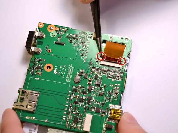

  12. Magellan RoadMate 1440 Screen Replacement: crwdns2935265:012crwdnd2935265:01crwdnd2935265:02crwdne2935265:0 Magellan RoadMate 1440 Screen Replacement: crwdns2935265:012crwdnd2935265:02crwdnd2935265:02crwdne2935265:0
    • With the ribbon cable removed, the screen is completely disconnected from the device.
    • To replace the ribbon cable, press the two tabs to push the head into the socket.

This is an amazingly clear and precise set of steps that I was able to use to remove the broken screen on my Magellan Roadmate 1475T.
I followed the directions exactly up to step 9(“removing the screen”) which I skipped over and went directly to step 11(“removing the ribbon cable from the socket”).
By detaching the ribbon cable from the mother board at this point, it eliminated the fumbling and possible damage to the connections on the mother board, and gave me direct access to the front frame which was holding the screen. When the front frame was separated from the rest of the device it was very easy then to just pop out the broken screen from the frame without needing any tools or extra hands.
Thank you for this extremely helpful tutorial!
