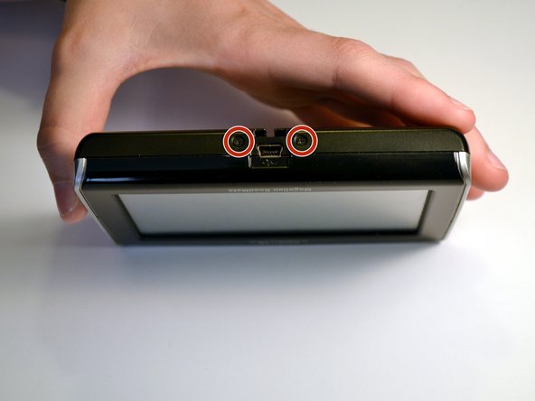

    • Remove the two 4.2mm screws at the bottom of the device using a Phillips #0 screwdriver.

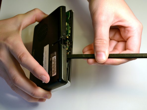

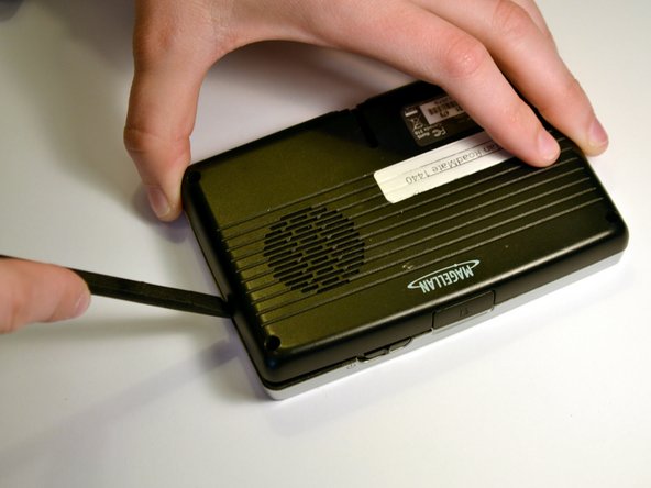

  4. Magellan RoadMate 1440 Power Switch Replacement: crwdns2935265:04crwdnd2935265:01crwdnd2935265:03crwdne2935265:0 Magellan RoadMate 1440 Power Switch Replacement: crwdns2935265:04crwdnd2935265:02crwdnd2935265:03crwdne2935265:0 Magellan RoadMate 1440 Power Switch Replacement: crwdns2935265:04crwdnd2935265:03crwdnd2935265:03crwdne2935265:0
    • Insert the black spudger into the crease in the side of the GPS.
    • Move the end of the spudger down to break the seal between the two plastic shells.
    • Continue doing this along each side of the GPS to ensure a smooth removal.

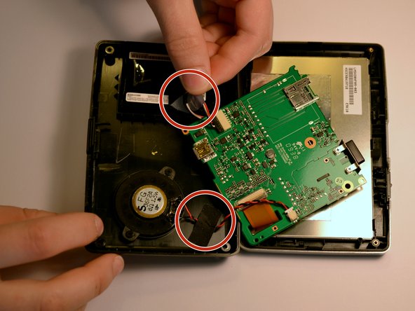

  5. Magellan RoadMate 1440 Power Switch Replacement: crwdns2935265:05crwdnd2935265:01crwdnd2935265:03crwdne2935265:0 Magellan RoadMate 1440 Power Switch Replacement: crwdns2935265:05crwdnd2935265:02crwdnd2935265:03crwdne2935265:0 Magellan RoadMate 1440 Power Switch Replacement: crwdns2935265:05crwdnd2935265:03crwdnd2935265:03crwdne2935265:0
    • Fully separate the two sides of the case.
    • Remove the tape on the battery wires and the tape on the speaker wires.

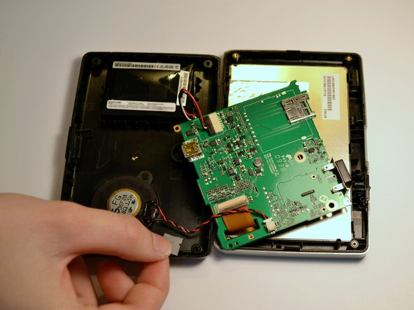

  6. Magellan RoadMate 1440 Power Switch Replacement, Power Switch: crwdns2935265:06crwdnd2935265:01crwdnd2935265:01crwdne2935265:0
    • Once the back cover has been removed, lift the power switch from the device.
    • This is only a sliding switch, the button to power the device on is inside the unit
