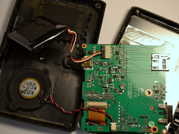

  5. Magellan RoadMate 1440 Antenna Replacement: crwdns2935265:05crwdnd2935265:01crwdnd2935265:03crwdne2935265:0 Magellan RoadMate 1440 Antenna Replacement: crwdns2935265:05crwdnd2935265:02crwdnd2935265:03crwdne2935265:0 Magellan RoadMate 1440 Antenna Replacement: crwdns2935265:05crwdnd2935265:03crwdnd2935265:03crwdne2935265:0
    • Fully separate the two sides of the case.
    • Remove the tape on the battery wires and the tape on the speaker wires.

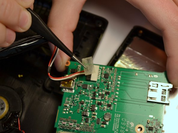

  7. Magellan RoadMate 1440 Antenna Replacement: crwdns2935265:07crwdnd2935265:01crwdnd2935265:02crwdne2935265:0 Magellan RoadMate 1440 Antenna Replacement: crwdns2935265:07crwdnd2935265:02crwdnd2935265:02crwdne2935265:0
    • Lift the battery from the device
    • Once the battery is free from the adhesive, remove the piece of tape with a pair of tweezers that is covering the connection of the battery to the motherboard.

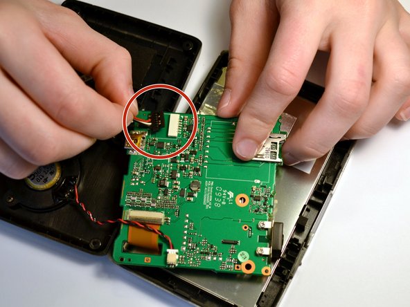

  8. Magellan RoadMate 1440 Antenna Replacement: crwdns2935265:08crwdnd2935265:01crwdnd2935265:02crwdne2935265:0 Magellan RoadMate 1440 Antenna Replacement: crwdns2935265:08crwdnd2935265:02crwdnd2935265:02crwdne2935265:0
    • Unplug the battery from the mother board by pulling back the clips and pulling the wires away from the motherboards receptacle
    • It is important for your and the device's safety to remove the battery before continuing with any other part removals.
    • It is not necessary to separate the red and white wires from the battery. A replacement battery pack will come with similar wires already attached.

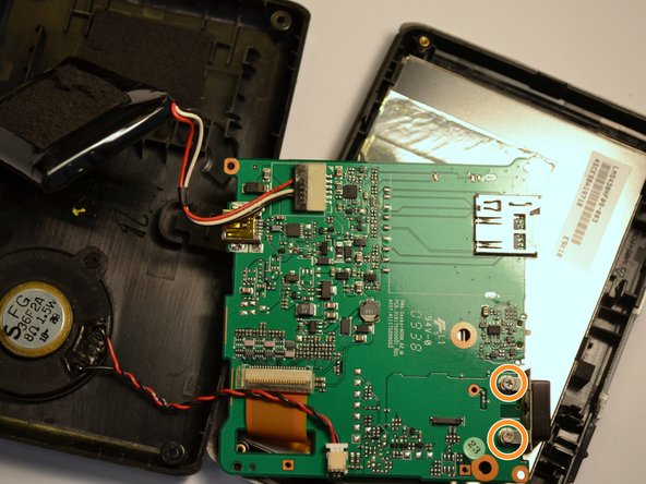

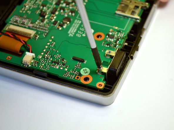

  9. Magellan RoadMate 1440 Antenna Replacement, Antenna: crwdns2935265:09crwdnd2935265:01crwdnd2935265:03crwdne2935265:0 Magellan RoadMate 1440 Antenna Replacement, Antenna: crwdns2935265:09crwdnd2935265:02crwdnd2935265:03crwdne2935265:0 Magellan RoadMate 1440 Antenna Replacement, Antenna: crwdns2935265:09crwdnd2935265:03crwdnd2935265:03crwdne2935265:0
    • Identify the antenna.
    • Locate the two screws in the antenna.
    • Use a Phillips #0 screwdriver to remove the two 2.5mm Phillips #0 screws.
  10. Magellan RoadMate 1440 Antenna Replacement: crwdns2935265:010crwdnd2935265:01crwdnd2935265:01crwdne2935265:0
    • After the screws have been removed, move the motherboard so that it is sitting in the side with the speaker and battery.
    • Using a soldering iron, melt the solder connecting the antenna to the motherboard. For instructions on how to use the soldering iron, refer to Soldering Technique Guide for instructions.
    • The soldering iron will be hot. Handle it with caution.
