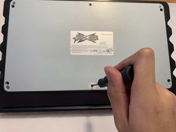

    • Remove the four 3mm screws with a Philips #0 screwdriver.

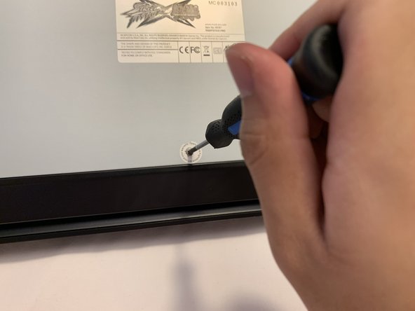

    • Remove the six 0.9mm screws with a Phillips #00 screwdriver.

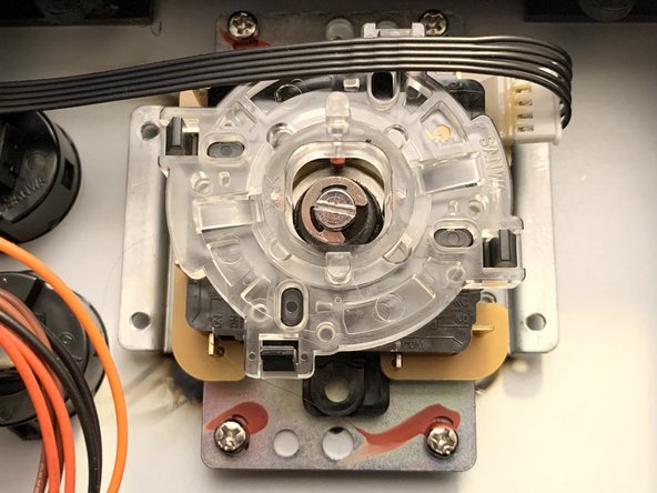

    • Remove the metal plate cover.
    • Find the lever inside of the controller.

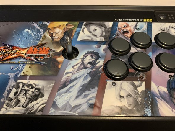

    • Insert your Flathead screwdriver into the middle of the lever to hold it in place.
    • Twist the ball to remove it from the lever.
    • Remove the ball top from the lever.

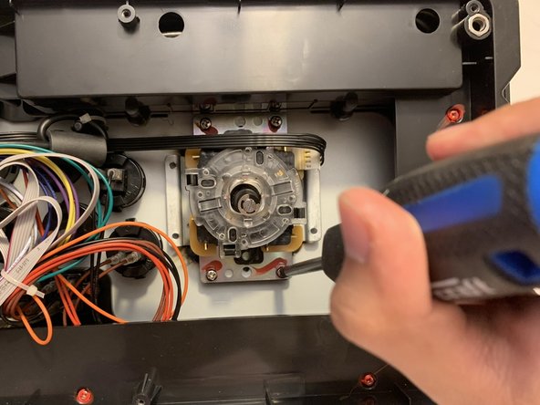

    • Remove the four 1.1mm screws holding the lever in place with your Phillips #0 screwdriver.

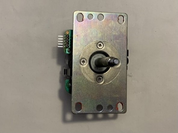

    • Remove the lever from the casing of the controller.
  8. Mad Catz Street Fighter X Tekken Pro Fightstick Lever Replacement: crwdns2935265:08crwdnd2935265:01crwdnd2935265:02crwdne2935265:0 Mad Catz Street Fighter X Tekken Pro Fightstick Lever Replacement: crwdns2935265:08crwdnd2935265:02crwdnd2935265:02crwdne2935265:0
    • Pull the cable connected to the lever out of the socket.
    • Remove the lever from the case.
