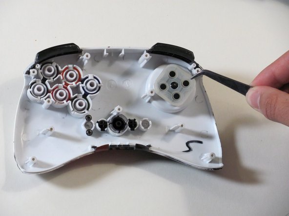

  8. Mad Catz Street Fighter IV FightPad Front Case Replacement, Buttons: crwdns2935265:08crwdnd2935265:01crwdnd2935265:02crwdne2935265:0 Mad Catz Street Fighter IV FightPad Front Case Replacement, Buttons: crwdns2935265:08crwdnd2935265:02crwdnd2935265:02crwdne2935265:0
    • Remove the six buttons one by one by gripping the back of each one and pushing on them from the front.
    • Use tweezers to remove the rubber part of the directional pad before you try to remove the shoulder buttons.
    • When reinserting the buttons make sure they are in the correct place and oriented correctly.

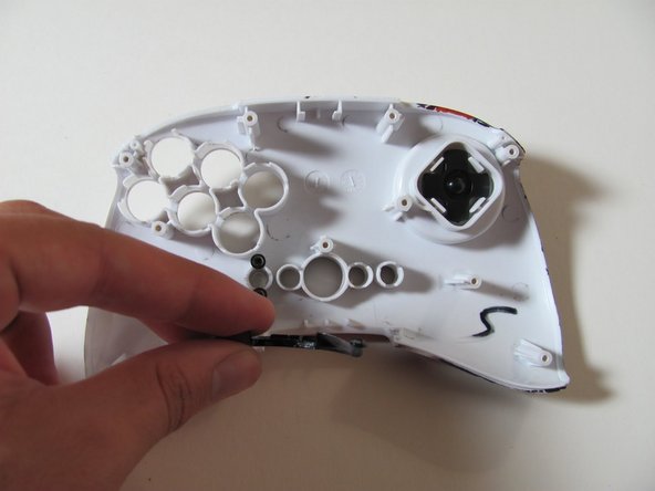

  9. Mad Catz Street Fighter IV FightPad Front Case Replacement: crwdns2935265:09crwdnd2935265:01crwdnd2935265:01crwdne2935265:0
    • Remove the left and right shoulder buttons by sliding them out of their respective slots.
  10. Mad Catz Street Fighter IV FightPad Front Case Replacement, Front Case: crwdns2935265:010crwdnd2935265:01crwdnd2935265:02crwdne2935265:0 Mad Catz Street Fighter IV FightPad Front Case Replacement, Front Case: crwdns2935265:010crwdnd2935265:02crwdnd2935265:02crwdne2935265:0
    • Pull the plastic piece out from the bottom of the controller.
