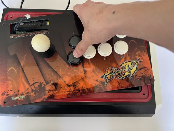

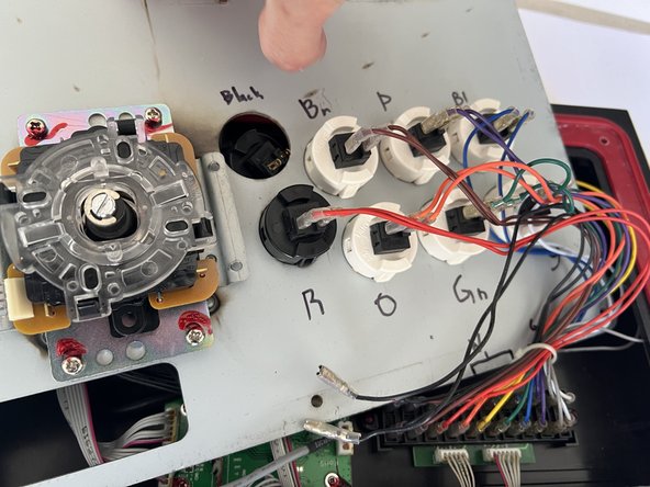

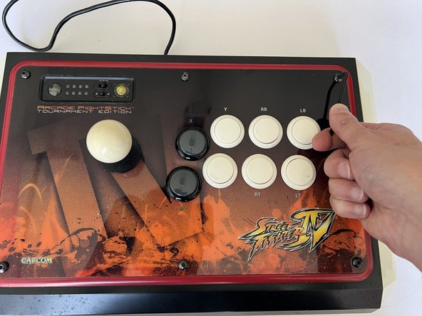

    • Place the controller on a flat surface, with the front facing you as you would normally use it.
    • Use a 3 mm Hex key to remove all six top-facing screws.
  2. Mad Catz Street Fighter IV Fight Stick Buttons Replacement: crwdns2935265:02crwdnd2935265:01crwdnd2935265:01crwdne2935265:0
    • Lift the top lid up and away from you.
    • Don't pull or yank the lid off as it is connected to the controller by multiple cables and they could be ripped out or damaged.
    • If you are changing multiple buttons, be sure to note the wire colors and/or use a marker to label each pairing.

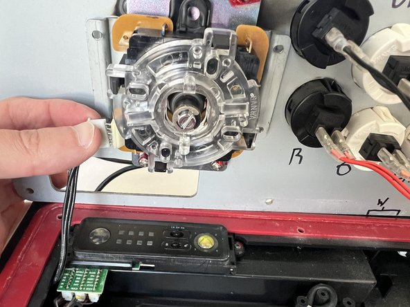

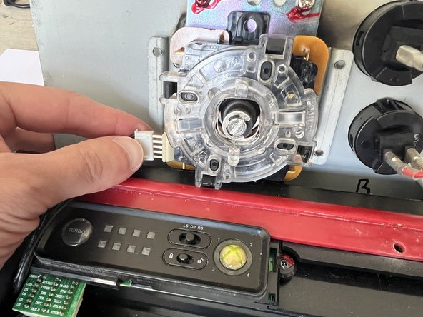

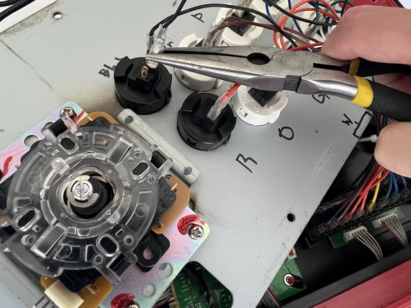

    • Use the needle nose pliers to loosen the lever to board 4-pin connection.
    • Once it's loose, disconnect the connector by hand to minimize the risk of accidentally damaging the plastic adapter.

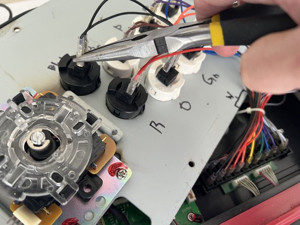

  4. Mad Catz Street Fighter IV Fight Stick Buttons Replacement: crwdns2935265:04crwdnd2935265:01crwdnd2935265:03crwdne2935265:0 Mad Catz Street Fighter IV Fight Stick Buttons Replacement: crwdns2935265:04crwdnd2935265:02crwdnd2935265:03crwdne2935265:0 Mad Catz Street Fighter IV Fight Stick Buttons Replacement: crwdns2935265:04crwdnd2935265:03crwdnd2935265:03crwdne2935265:0

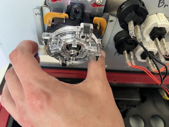

    • Completely flip the lid over with the lever resting inside the box.
    • Use pliers to gently squeeze and disconnect the pin connectors located at the bottom of the button you wish to replace.

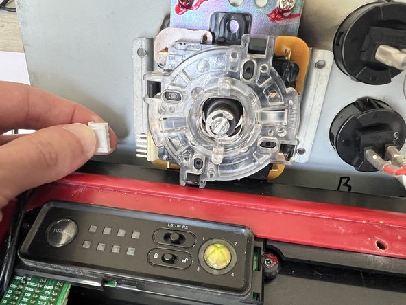

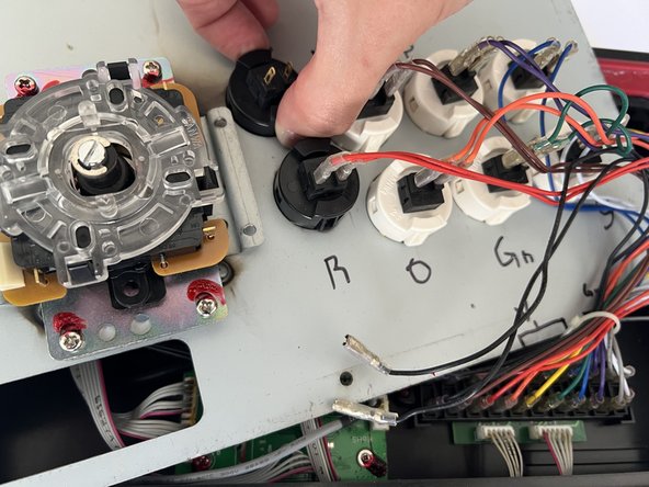

    • Remove the button by simultaneously squeezing both push tabs on either side and gently pressing down to release it.
  6. Mad Catz Street Fighter IV Fight Stick Buttons Replacement: crwdns2935265:06crwdnd2935265:01crwdnd2935265:03crwdne2935265:0 Mad Catz Street Fighter IV Fight Stick Buttons Replacement: crwdns2935265:06crwdnd2935265:02crwdnd2935265:03crwdne2935265:0 Mad Catz Street Fighter IV Fight Stick Buttons Replacement: crwdns2935265:06crwdnd2935265:03crwdnd2935265:03crwdne2935265:0

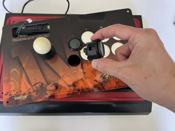

    • Replace the button by gently pressing it into the slot until it clicks into place.

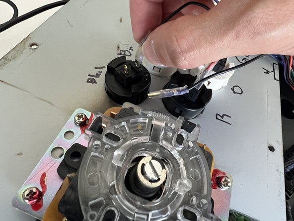

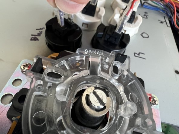

    • Reconnect button wires in any order.
    • Pull the plastic sheath away to reveal the pin connector.
    • Push the button pin down until the connector fully covers it, then slide the plastic sheath securely over the connector.
  8. Mad Catz Street Fighter IV Fight Stick Buttons Replacement: crwdns2935265:08crwdnd2935265:01crwdnd2935265:03crwdne2935265:0 Mad Catz Street Fighter IV Fight Stick Buttons Replacement: crwdns2935265:08crwdnd2935265:02crwdnd2935265:03crwdne2935265:0 Mad Catz Street Fighter IV Fight Stick Buttons Replacement: crwdns2935265:08crwdnd2935265:03crwdnd2935265:03crwdne2935265:0
    • Reconnect the lever link by aligning the plastic adapter with the pins, ensuring everything is properly positioned, as the pins can easily bend.
    • Push it into place by using your thumb on the opposite end of the stick as leverage. Do so until flush, with no metal left exposed.
