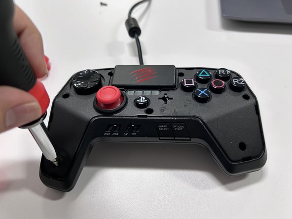

    • Remove the single 6 mm screw on the back shell of the controller using a Phillips #00 screwdriver.

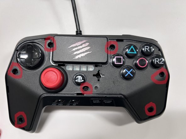

  3. Mad Catz FightPad PRO Joystick Replacement, Step 3: crwdns2935265:03crwdnd2935265:01crwdnd2935265:03crwdne2935265:0 Mad Catz FightPad PRO Joystick Replacement, Step 3: crwdns2935265:03crwdnd2935265:02crwdnd2935265:03crwdne2935265:0 Mad Catz FightPad PRO Joystick Replacement, Step 3: crwdns2935265:03crwdnd2935265:03crwdnd2935265:03crwdne2935265:0
    • Remove the seven screws using a Phillips #00 screwdriver.

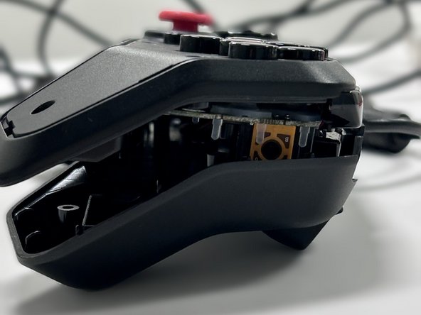

    • Detach the controller from the back shell.
    • Be gentle because you could damage the motherboard with too much pressure.

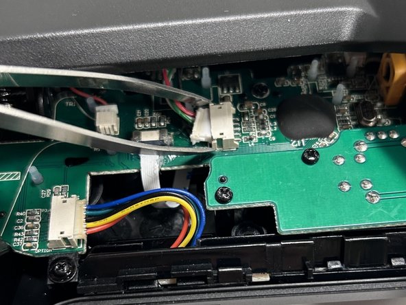

  5. Mad Catz FightPad PRO Joystick Replacement, Step 5: crwdns2935265:05crwdnd2935265:01crwdnd2935265:03crwdne2935265:0 Mad Catz FightPad PRO Joystick Replacement, Step 5: crwdns2935265:05crwdnd2935265:02crwdnd2935265:03crwdne2935265:0 Mad Catz FightPad PRO Joystick Replacement, Step 5: crwdns2935265:05crwdnd2935265:03crwdnd2935265:03crwdne2935265:0

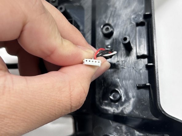

    • Using tweezers or your fingers, detach the wires connecting the motherboard to the rest of the controller.

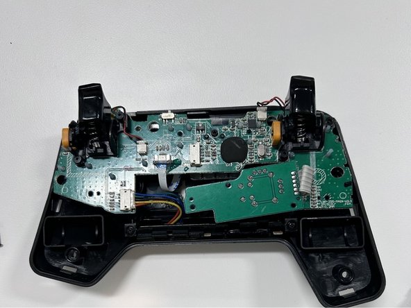

    • Remove the eight 6 mm screws from the motherboard using a Phillips #00 screwdriver.
    • Once the screws are removed, the inner parts of the controller will start to fall apart. Keeping the controller facedown will prevent any parts from falling out.

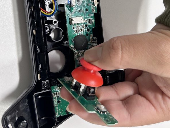

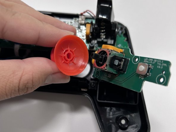

  7. Mad Catz FightPad PRO Joystick Replacement, Step 7: crwdns2935265:07crwdnd2935265:01crwdnd2935265:02crwdne2935265:0 Mad Catz FightPad PRO Joystick Replacement, Step 7: crwdns2935265:07crwdnd2935265:02crwdnd2935265:02crwdne2935265:0
    • Using your fingers carefully remove the joystick until you hear a pop noise.

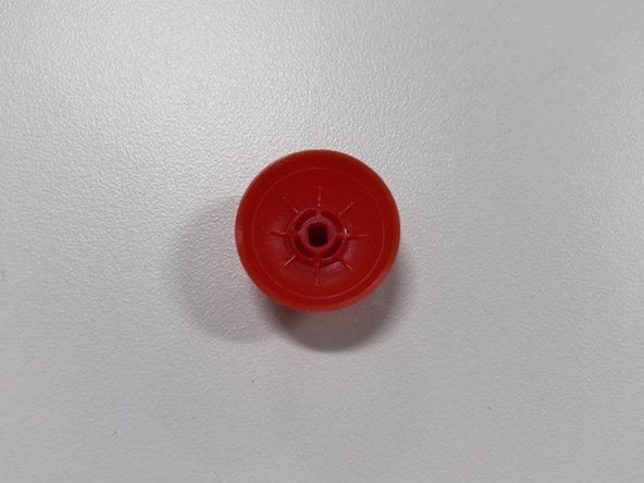

  8. Mad Catz FightPad PRO Joystick Replacement: crwdns2935265:08crwdnd2935265:01crwdnd2935265:03crwdne2935265:0 Mad Catz FightPad PRO Joystick Replacement: crwdns2935265:08crwdnd2935265:02crwdnd2935265:03crwdne2935265:0 Mad Catz FightPad PRO Joystick Replacement: crwdns2935265:08crwdnd2935265:03crwdnd2935265:03crwdne2935265:0
    • Make sure that the new joystick and motherboard pieces match before placing them together.
    • Hold down on the joystick until you hear a click noise.
