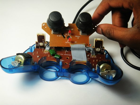

    • Remove the six 7 mm Phillips screws from the rear cover.
  2. Mad Catz Dual Force 2 Pro Motherboard Replacement: crwdns2935265:02crwdnd2935265:01crwdnd2935265:01crwdne2935265:0
    • Remove the back of the controller.
    • There are no loose items in the controller that can fall out, so you can open it, generally, however you want.
  3. Mad Catz Dual Force 2 Pro Motherboard Replacement: crwdns2935265:03crwdnd2935265:01crwdnd2935265:01crwdne2935265:0
    • Remove the two 7 mm screws on the closest circuit board.
  4. Mad Catz Dual Force 2 Pro Motherboard Replacement: crwdns2935265:04crwdnd2935265:01crwdnd2935265:02crwdne2935265:0 Mad Catz Dual Force 2 Pro Motherboard Replacement: crwdns2935265:04crwdnd2935265:02crwdnd2935265:02crwdne2935265:0
    • Lift the closest circuit board away from the motherboard.
    • Be sure you do not tear the ribbon connecting the smaller circuit board to the motherboard.
  5. Mad Catz Dual Force 2 Pro Motherboard Replacement: crwdns2935265:05crwdnd2935265:01crwdnd2935265:01crwdne2935265:0
    • Remove the two 7 mm Philip screws on the motherboard.
  6. Mad Catz Dual Force 2 Pro Motherboard Replacement: crwdns2935265:06crwdnd2935265:01crwdnd2935265:01crwdne2935265:0
    • Remove the motherboard assembly from the cover.
