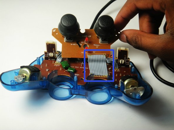

    • Lift the closest circuit board away from the motherboard.
    • Potential for device damage. Be sure you do not tear the ribbon connecting the smaller circuit board to the motherboard.
  5. Mad Catz Dual Force 2 Pro Analog Joystick Covers Replacement: crwdns2935265:05crwdnd2935265:01crwdnd2935265:01crwdne2935265:0
    • Grip the analog stick you wish to remove and the smaller circuit board or the cover.
    • Pull the analog stick from the smaller circuit board.
