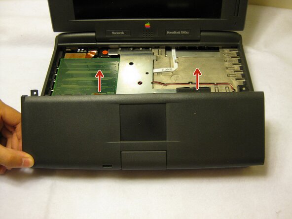

    1. Macintosh Powerbook 5300cs Trackpad Replacement, Trackpad: crwdns2935265:06crwdnd2935265:01crwdnd2935265:03crwdne2935265:0 Macintosh Powerbook 5300cs Trackpad Replacement, Trackpad: crwdns2935265:06crwdnd2935265:02crwdnd2935265:03crwdne2935265:0 Macintosh Powerbook 5300cs Trackpad Replacement, Trackpad: crwdns2935265:06crwdnd2935265:03crwdnd2935265:03crwdne2935265:0
      • Remove the front plastic panel of the laptop by carefully lifting it up and forward.
      • There will be another another ribbon cable connecting the trackpad; use caution when lifting the front panel.
