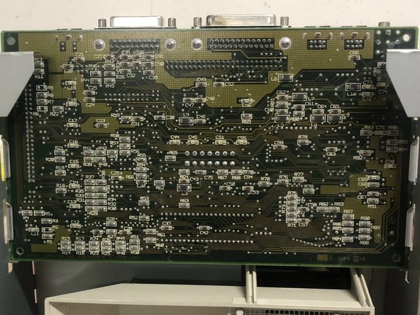

  3. Macintosh Classic disassembly, Removing the motherboard.: crwdns2935265:03crwdnd2935265:01crwdnd2935265:02crwdne2935265:0 Macintosh Classic disassembly, Removing the motherboard.: crwdns2935265:03crwdnd2935265:02crwdnd2935265:02crwdne2935265:0
    • The motherboard has no screws, so it can be removed by pulling upwards.
    • Make sure to disconnect all cables.
