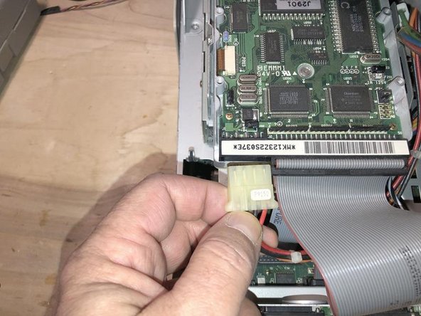

    • Here is the Hard Drive. It is actually mounted upside down. You are looking at the drive controller board
    • Remove the power cable

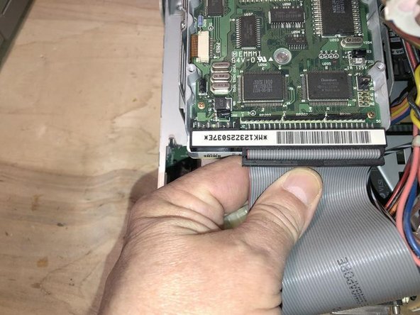

    • Next remove the data cable. The red stripe always connects to pin 1 of the connector
  7. Macintosh Classic II Hard Drive Removal: crwdns2935265:07crwdnd2935265:01crwdnd2935265:03crwdne2935265:0 Macintosh Classic II Hard Drive Removal: crwdns2935265:07crwdnd2935265:02crwdnd2935265:03crwdne2935265:0 Macintosh Classic II Hard Drive Removal: crwdns2935265:07crwdnd2935265:03crwdnd2935265:03crwdne2935265:0
    • To remove the cable, simply pull it toward the back. No locking tabs etc. on these.

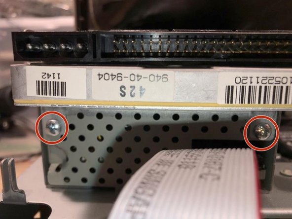

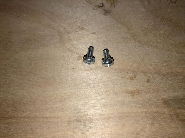

    • There are two (2) Philips head screws that hold the HDD caddy. Remove those
    • The screws are M3 by 8mm machine screws

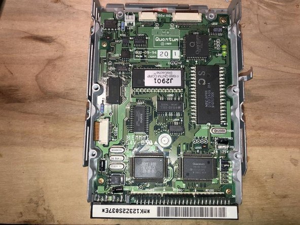

    • With the two (2) screws removed, simply remove the Hard Drive with caddy out of the chassis.
    • The drive is a Quantum ProDrive LPS 42S 40GB SCSI Hard Drive - Apple 940-40-9404
