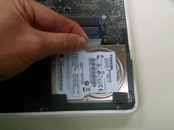

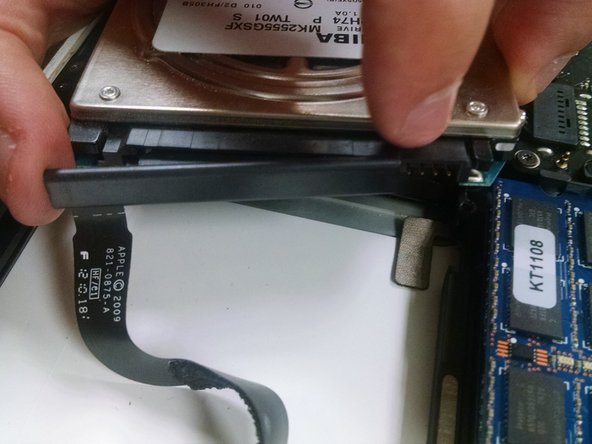

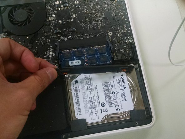

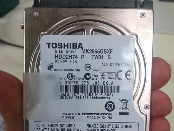

  4. Macbook 2009-2010 Unibody White Disassembly, Removing Hard Drive Part 2: crwdns2935265:04crwdnd2935265:01crwdnd2935265:03crwdne2935265:0 Macbook 2009-2010 Unibody White Disassembly, Removing Hard Drive Part 2: crwdns2935265:04crwdnd2935265:02crwdnd2935265:03crwdne2935265:0 Macbook 2009-2010 Unibody White Disassembly, Removing Hard Drive Part 2: crwdns2935265:04crwdnd2935265:03crwdnd2935265:03crwdne2935265:0
    • After removing the screws and plastic cover piece, remove the hard drive then unplug from Logic Board.

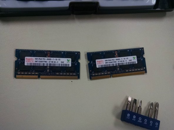

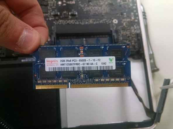

  5. Macbook 2009-2010 Unibody White Disassembly, Removing The RAM: crwdns2935265:05crwdnd2935265:01crwdnd2935265:03crwdne2935265:0 Macbook 2009-2010 Unibody White Disassembly, Removing The RAM: crwdns2935265:05crwdnd2935265:02crwdnd2935265:03crwdne2935265:0 Macbook 2009-2010 Unibody White Disassembly, Removing The RAM: crwdns2935265:05crwdnd2935265:03crwdnd2935265:03crwdne2935265:0
    • Locate the RAM Directly above the Hard Drive. Gently push the two snaps away from the RAM cards and gently pull the ram out. You Will do this step again to remove the Second card beneath the first.
