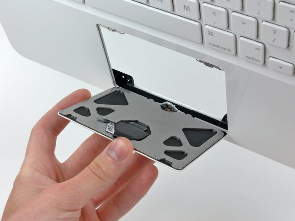

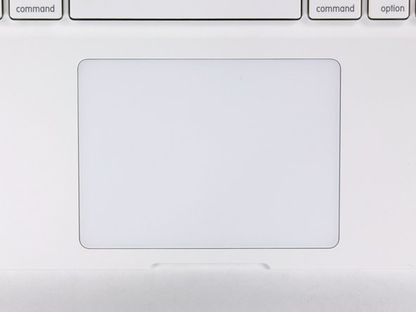

  42. MacBook Unibody Model A1342 Upper Case Replacement, Upper Case: crwdns2935265:042crwdnd2935265:01crwdnd2935265:01crwdne2935265:0
    • Remove the four 1.3 mm Phillips screws securing the upper edge of the trackpad to the upper case.
  43. MacBook Unibody Model A1342 Upper Case Replacement: crwdns2935265:043crwdnd2935265:01crwdnd2935265:01crwdne2935265:0
    • Carefully tilt the trackpad away from the keyboard side of the upper case.
    • Pull the trackpad away from its opening in the upper case to clear the two mounting tabs on its lower edge.

    • Use the following steps to install the old trackpad into your new upper case.
    • Reinstall the T6 Torx set screw until it is flush with the aluminum bracket surrounding the trackpad.
    • Place the trackpad back into its void in the upper case, being sure the lower tabs are inserted underneath the keyboard side of the upper case.
    • Be sure the trackpad ribbon cable is not pinched between the trackpad and the upper case.
  46. MacBook Unibody Model A1342 Upper Case Replacement: crwdns2935265:046crwdnd2935265:01crwdnd2935265:02crwdne2935265:0 MacBook Unibody Model A1342 Upper Case Replacement: crwdns2935265:046crwdnd2935265:02crwdnd2935265:02crwdne2935265:0
    • Reinstall the four silver Phillips screws securing the trackpad to its steel brackets.
    • Loosen all four silver screws about 1/16th of a turn.
    • Flip the upper case over and adjust the position of the trackpad until the gap between the trackpad and the upper case is evenly spaced around the perimeter of the trackpad.
    • Tighten the four silver screws to hold the trackpad in place.
    • Repeat this process until the trackpad is perfectly positioned in its void on the upper case.
  47. MacBook Unibody Model A1342 Upper Case Replacement: crwdns2935265:047crwdnd2935265:01crwdnd2935265:01crwdne2935265:0
    • While repeatedly pressing the trackpad to simulate clicking, tighten the T6 Torx set screw until the trackpad no longer wiggles freely.
    • Do not over-tighten the set screw, as the button will cease to click at a certain point. Adjust the set screw until the movable side of the trackpad has minimal play.
