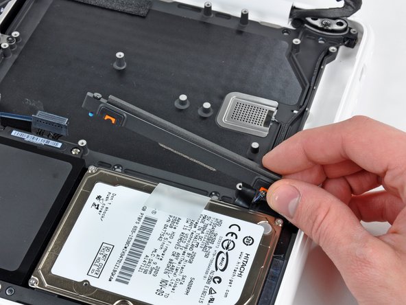

  22. MacBook Unibody Model A1342 Upper Case Replacement: crwdns2935265:022crwdnd2935265:01crwdnd2935265:01crwdne2935265:0
    • Lift the free side of the hard drive and pull it away from the side of the upper case.
    • The hard drive is still attached to the upper case by the hard drive cable.
  23. MacBook Unibody Model A1342 Upper Case Replacement: crwdns2935265:023crwdnd2935265:01crwdnd2935265:02crwdne2935265:0 MacBook Unibody Model A1342 Upper Case Replacement: crwdns2935265:023crwdnd2935265:02crwdnd2935265:02crwdne2935265:0
    • Disconnect the hard drive by pulling the hard drive cable connector away from its socket on the hard drive.

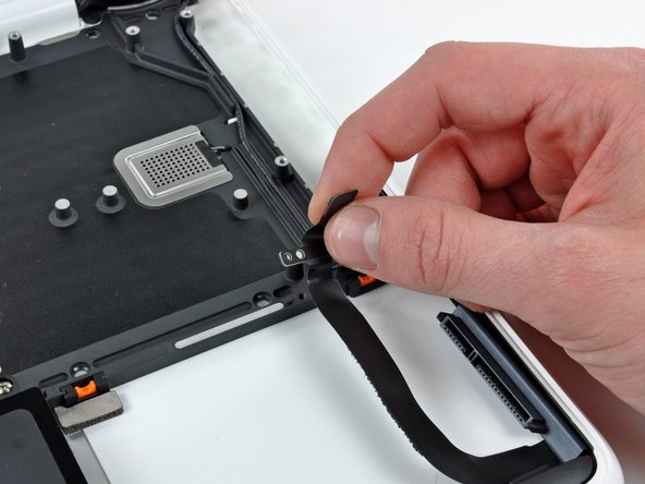

  24. MacBook Unibody Model A1342 Upper Case Replacement: crwdns2935265:024crwdnd2935265:01crwdnd2935265:02crwdne2935265:0 MacBook Unibody Model A1342 Upper Case Replacement: crwdns2935265:024crwdnd2935265:02crwdnd2935265:02crwdne2935265:0
    • Remove the single 3.1 mm Phillips screw securing the hard drive cable to the upper case.
    • Lift the hard drive cable out of the upper case.

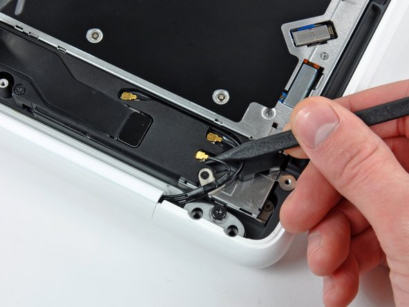

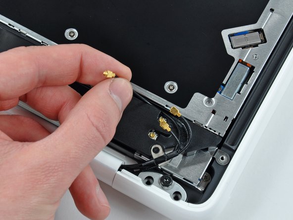

  29. MacBook Unibody Model A1342 Upper Case Replacement: crwdns2935265:029crwdnd2935265:01crwdnd2935265:03crwdne2935265:0 MacBook Unibody Model A1342 Upper Case Replacement: crwdns2935265:029crwdnd2935265:02crwdnd2935265:03crwdne2935265:0 MacBook Unibody Model A1342 Upper Case Replacement: crwdns2935265:029crwdnd2935265:03crwdnd2935265:03crwdne2935265:0
    • Use the tip of a spudger to pry the AirPort/Bluetooth antenna connectors (three total) up off the AirPort/Bluetooth board.
    • If necessary, de-route the long antenna cable from its slot in the rear speaker housing.
  30. MacBook Unibody Model A1342 Upper Case Replacement: crwdns2935265:030crwdnd2935265:01crwdnd2935265:01crwdne2935265:0
    • Remove the single 3 mm Phillips screw securing the antenna ground straps to the rear speaker housing.

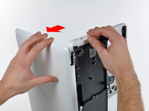

  39. MacBook Unibody Model A1342 Upper Case Replacement: crwdns2935265:039crwdnd2935265:01crwdnd2935265:02crwdne2935265:0 MacBook Unibody Model A1342 Upper Case Replacement: crwdns2935265:039crwdnd2935265:02crwdnd2935265:02crwdne2935265:0
    • Grab the upper case with your right hand and rotate it slightly toward the top of the display so the upper display bracket clears the edge of the upper case.
    • The display data cable may cause the upper display bracket to get caught on the upper case. It may be helpful to slightly rotate the upper case away from the display for more clearance.
    • Rotate the display slightly away from the upper case.
  40. MacBook Unibody Model A1342 Upper Case Replacement: crwdns2935265:040crwdnd2935265:01crwdnd2935265:01crwdne2935265:0
    • Lift the display up and away from the upper case, minding any brackets or cables that may get caught.

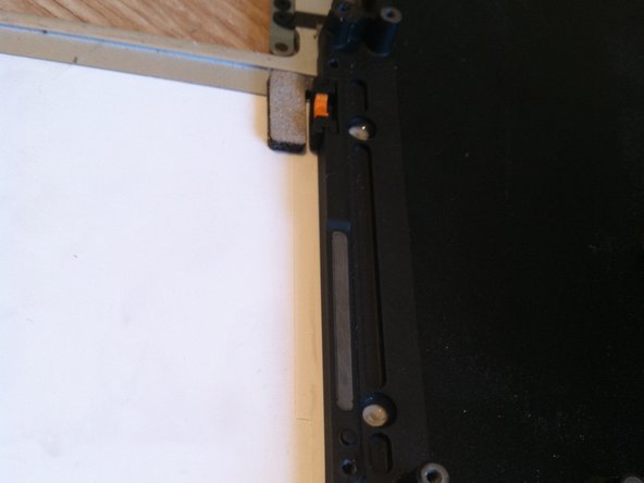

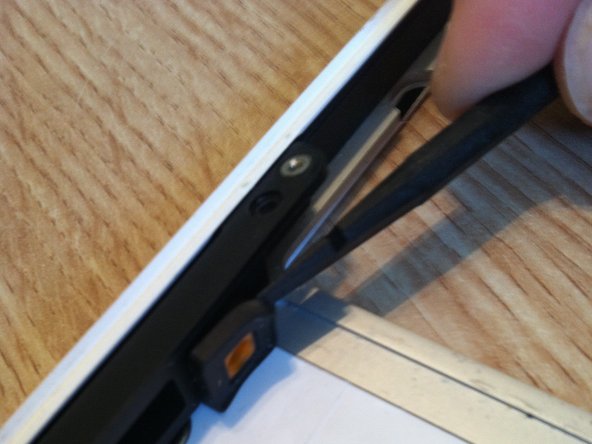

  41. MacBook Unibody Model A1342 Upper Case Replacement: crwdns2935265:041crwdnd2935265:01crwdnd2935265:03crwdne2935265:0 MacBook Unibody Model A1342 Upper Case Replacement: crwdns2935265:041crwdnd2935265:02crwdnd2935265:03crwdne2935265:0 MacBook Unibody Model A1342 Upper Case Replacement: crwdns2935265:041crwdnd2935265:03crwdnd2935265:03crwdne2935265:0
    • There are four orange and black rubber inserts that the hard drive sits in. One side has full circles and the other side has half circles. (The other side of the half circles are located on the hard drive bracket that was previously removed).
    • The new upper case may not have these inserts. Be sure to remove them from the old and insert into the new.
    • The inserts are easily pried out with a spudger or a flat tipped screwdriver. They are not glued in, but instead have notched sides to hold them in place.
