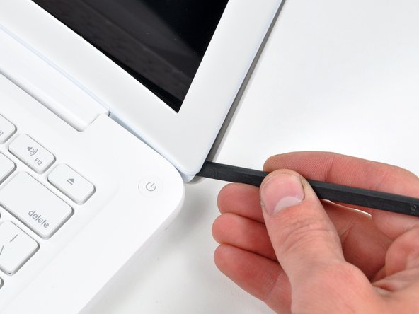

    • Insert the flat end of a spudger between the thin rubber strip surrounding the front display bezel and the rear display bezel.
    • Do not try to insert the spudger between the thin rubber strip and the plastic face of the front display bezel.
    • Use the flat end of your spudger to carefully pry the front display bezel away from the adhesive securing it to the rear display bezel.
    • Do not pry against the fragile glass LCD panel. Also, do not excessively bend the plastic, as it may permanently deform.
    • Continue prying until the front display bezel is free along the right side of the display and behind the right clutch hinge.

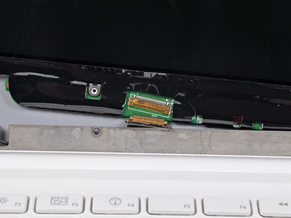

    • Peel the piece of tape covering the display data cable connector away from the edge closest to the LCD.
  8. MacBook Unibody Model A1342 LCD Replacement: crwdns2935265:08crwdnd2935265:01crwdnd2935265:02crwdne2935265:0 MacBook Unibody Model A1342 LCD Replacement: crwdns2935265:08crwdnd2935265:02crwdnd2935265:02crwdne2935265:0
    • Use the tip of a spudger to flip up the thin steel retaining clip securing the display data cable to its socket on the LCD.
    • While holding the display data cable by the retaining clip, pull the LCD straight up and away from its socket.
    • Lift the LCD out of the display assembly and set it aside.

Thanks for this helpful guide. However, is it just me, or did you leave out the most difficult step in the whole process? How does one get the display data cable into the socket on the new lcd?
davehuff - crwdns2934203:0crwdne2934203:0
I thought exactly the same thing: towards the end, it gets really tricky and there should be a lot more details in the repair guide. I somehow figured out myself how to do it, but i think i wouldn't have dared to do the whole thing, if i had known how difficult it would be at the end. you need a lot of patience and sensitivity to fit the cable into the little socket.

I'm done with the repair. My MacBook looks beautiful with the new Anti-Glare iFixit LCD screen I love it. Getting the display data cable into the socket wasn't that bad. I could solve it in 5 minutes. But needed 4 hands :)
Everybody should try if the screen break and iFixit guys are really really helpful!! Thank you once again!!
