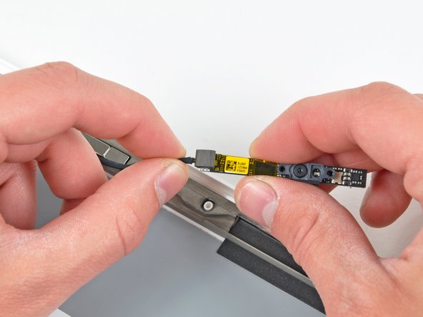

  28. MacBook Unibody Model A1342 Display Data/Camera Cable Replacement: crwdns2935265:028crwdnd2935265:01crwdnd2935265:02crwdne2935265:0 MacBook Unibody Model A1342 Display Data/Camera Cable Replacement: crwdns2935265:028crwdnd2935265:02crwdnd2935265:02crwdne2935265:0
    • Use the pointed tip of a spudger to pry the camera board off the display assembly.
    • Disconnect the camera cable by pulling its connector away from the socket on the camera board.
