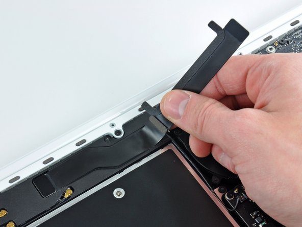

  4. MacBook Unibody Model A1342 AirPort/Bluetooth Cable Replacement, AirPort/Bluetooth Cable: crwdns2935265:04crwdnd2935265:01crwdnd2935265:02crwdne2935265:0 MacBook Unibody Model A1342 AirPort/Bluetooth Cable Replacement, AirPort/Bluetooth Cable: crwdns2935265:04crwdnd2935265:02crwdnd2935265:02crwdne2935265:0
    • Use the flat end of a spudger to pry the AirPort/Bluetooth cable connector up off the logic board.
    • Carefully peel the AirPort/Bluetooth ribbon cable from its channel within the rear speaker assembly.
  5. MacBook Unibody Model A1342 AirPort/Bluetooth Cable Replacement: crwdns2935265:05crwdnd2935265:01crwdnd2935265:01crwdne2935265:0
    • Use the flat end of a spudger to pry the AirPort/Bluetooth cable connector up off the right speaker.
