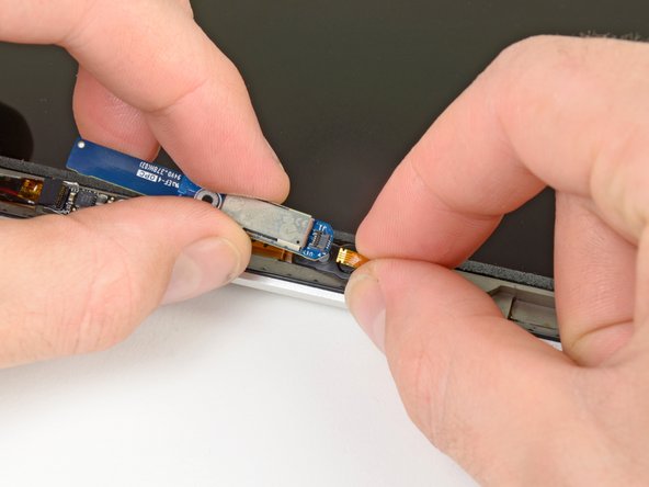

  28. MacBook Unibody Model A1278 iSight Camera Replacement: crwdns2935265:028crwdnd2935265:01crwdnd2935265:02crwdne2935265:0 MacBook Unibody Model A1278 iSight Camera Replacement: crwdns2935265:028crwdnd2935265:02crwdnd2935265:02crwdne2935265:0
    • Use the tip of a spudger or your fingernail to flip up the retaining flap on the Bluetooth board ribbon cable ZIF socket.
    • Pull the Bluetooth board ribbon cable out of its socket.
    • Lift and remove the Bluetooth board from the display assembly.

Step 28: It is very difficult to see which way to try and flip up the retaining flap.
it's from the end opposite from where the cable inserts (where the tip of the spudger is pointing in the picture), there is little room to fit anything in there unless you have some very long, thin nails. I cut a piece of plastic from some packaging and used it to flip the little bugger up. Hope this helps anyone else out there blessed with poor eyesight.
