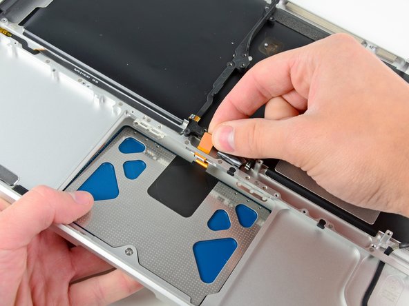

    • Grab the plastic pull tab secured to the display data cable lock and rotate it toward the DC-in side of the computer.
    • Pull the display data cable connector straight away from its socket.
    • Make sure to pull the connector straight away and not straight up from its socket.

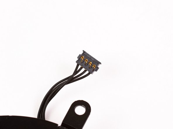

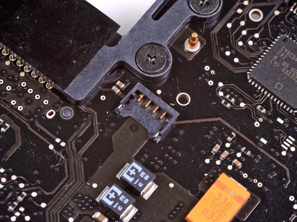

  22. MacBook Unibody Model A1278 Upper Case Replacement: crwdns2935265:022crwdnd2935265:01crwdnd2935265:03crwdne2935265:0 MacBook Unibody Model A1278 Upper Case Replacement: crwdns2935265:022crwdnd2935265:02crwdnd2935265:03crwdne2935265:0 MacBook Unibody Model A1278 Upper Case Replacement: crwdns2935265:022crwdnd2935265:03crwdnd2935265:03crwdne2935265:0
    • Use a spudger to pry the fan connector straight up and out of its socket on the logic board.
    • It is useful to twist the spudger axially from beneath the fan cable wires to release the connector.
    • The fan socket and the fan connector can be seen in the second and third pictures. Be careful not to break the plastic fan socket off the logic board as you use your spudger to lift the fan connector straight up and out of its socket. The layout of the logic board shown in the second picture may look slightly different than your machine but the fan socket is the same.

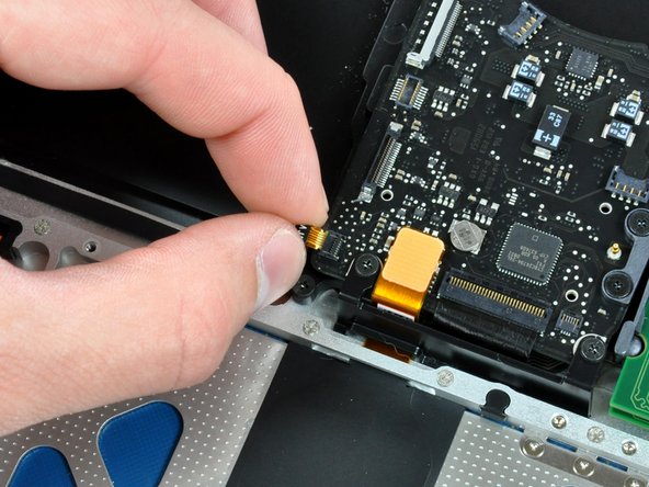

    • Use the tip of a spudger to flip up the locking lever to release the IR sensor ribbon cable from its socket.
    • Pull the IR sensor ribbon cable straight away from the logic board.

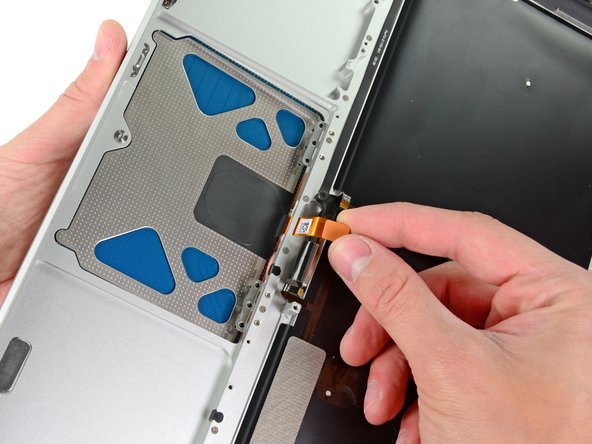

    • Use the flat end of a spudger to pry the trackpad connector straight up off the logic board.

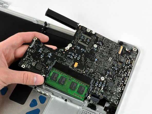

    • Remove the following five screws securing the logic board to the upper case:
    • Four 3 mm Phillips screws.
    • One 3.5 mm Phillips screw.
    • Remove the two 7 mm Phillips screws securing the DC-in board to the upper case.
    • Lift the logic board from its left edge and pull it out of the upper case.

    • Remove the six 1.4 mm Y0 Tri-wing screws securing the trackpad to the upper case.
  46. MacBook Unibody Model A1278 Upper Case Replacement: crwdns2935265:046crwdnd2935265:01crwdnd2935265:02crwdne2935265:0 MacBook Unibody Model A1278 Upper Case Replacement: crwdns2935265:046crwdnd2935265:02crwdnd2935265:02crwdne2935265:0
    • Carefully dislodge the edge of the trackpad closest to the keyboard from its recess in the upper case by pushing it away from the brackets attached to the upper case.
    • De-route the trackpad cable through its slot cut into the upper case.
  47. MacBook Unibody Model A1278 Upper Case Replacement: crwdns2935265:047crwdnd2935265:01crwdnd2935265:01crwdne2935265:0
    • Pull the trackpad away from the outer edge of the upper case.
    • Remove the trackpad and set it aside.

    • Carefully insert the cable from your old trackpad through its slot cut into your new upper case.
    • Use one hand to hold the trackpad cable in place as you insert the two retaining tabs on the outer edge of the trackpad under the lip on the upper case.
    • Pull the trackpad cable as you seat the trackpad into its void in your new upper case.
