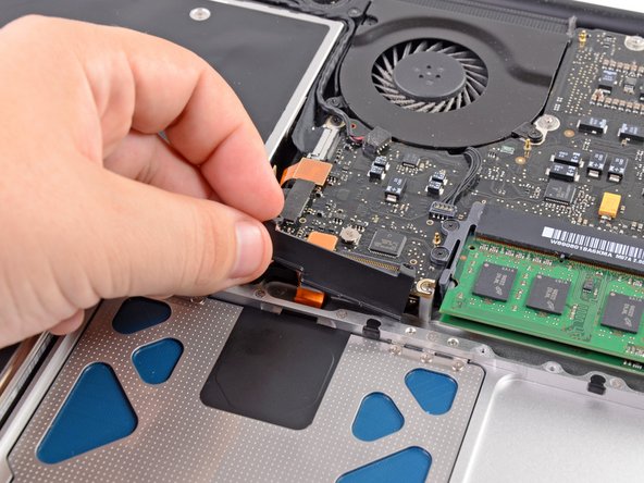

  9. MacBook Unibody Model A1278 Trackpad Replacement: crwdns2935265:09crwdnd2935265:01crwdnd2935265:01crwdne2935265:0
    • Use the flat end of a spudger to pry the trackpad connector straight up off the logic board.
  10. MacBook Unibody Model A1278 Trackpad Replacement: crwdns2935265:010crwdnd2935265:01crwdnd2935265:01crwdne2935265:0
    • Remove the six 1.4 mm Y0 Tri-point screws securing the trackpad to the upper case.
    These screw heads/slots are nasty small! I ordered the special screw driver with the trackpad because I didn’t have it, but it really doesn’t seem to be small enough to do the job properly. I guess I’ll blame Apple for the screws, but be warned that it is a stretch to get these screws out with the driver. I stripped 2 of the screws and had to drill the heads off them. Fortunately I had 4 left to reassemble the trackpad! Maybe iFixit should provide some of these screws, since they are so easily damaged.
    Stephen Wagner - crwdns2934203:0crwdne2934203:0
