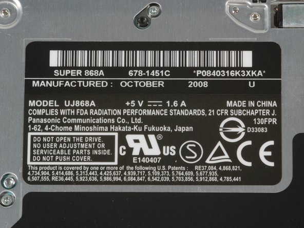

  15. MacBook Unibody Model A1278 Teardown: crwdns2935265:015crwdnd2935265:01crwdnd2935265:02crwdne2935265:0 MacBook Unibody Model A1278 Teardown: crwdns2935265:015crwdnd2935265:02crwdnd2935265:02crwdne2935265:0
    • The optical drive, now SATA.
    • The optical drive shows a manufacture date of October 2008. That drive sure got from the factory to us fast!

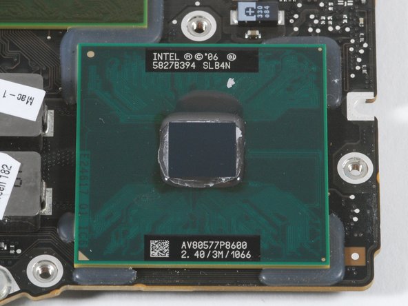

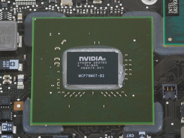

  17. MacBook Unibody Model A1278 Teardown: crwdns2935265:017crwdnd2935265:01crwdnd2935265:03crwdne2935265:0 MacBook Unibody Model A1278 Teardown: crwdns2935265:017crwdnd2935265:02crwdnd2935265:03crwdne2935265:0 MacBook Unibody Model A1278 Teardown: crwdns2935265:017crwdnd2935265:03crwdnd2935265:03crwdne2935265:0

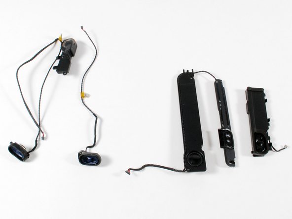

  19. MacBook Unibody Model A1278 Teardown: crwdns2935265:019crwdnd2935265:01crwdnd2935265:02crwdne2935265:0 MacBook Unibody Model A1278 Teardown: crwdns2935265:019crwdnd2935265:02crwdnd2935265:02crwdne2935265:0
    • Removing the right speaker and subwoofer.
    • The new MacBook received a welcome speaker upgrade. In the second image, the old plastic MacBook's speakers are on the left, and the new MacBook's speakers are on the right.
