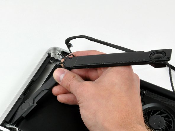

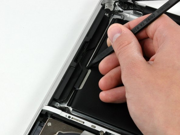

    • Peel back the small piece of black tape covering the right speaker cable.
    • Use the tip of a spudger to pry the right speaker up off the adhesive securing it to the upper case.
    • Lift the subwoofer and right speaker assembly out of the upper case.
