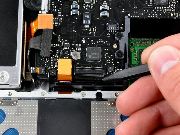

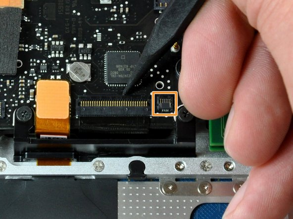

    • Use the tip of the spudger to lift the keyboard cable retaining flap.
    • Pull the cable away from its socket to disconnect it. Make sure you lift the retaining flap before pulling the cable or you could damage it.
    • Disconnect the cable on the right if your Mac has this. This cable is the backlight on the keyboard. Remove it in a similar way as above.

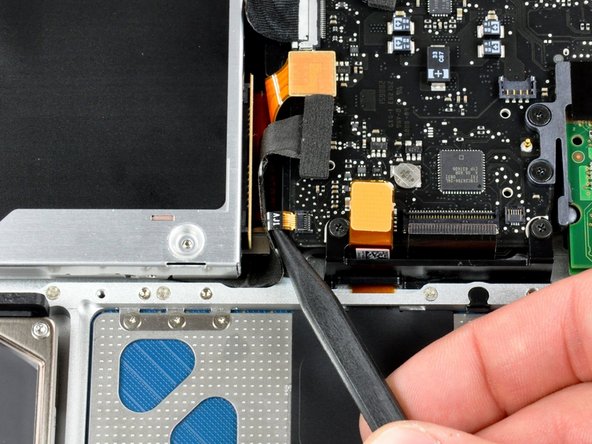

    • Use the flat end of the spudger to pry the trackpad cable straight from the logic board.

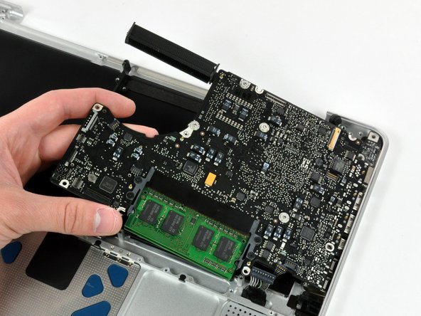

    • Remove the screws securing the logic board.
    • Four 3mm Phillips screws
    • One 3.5mm Phillips screw
    • The DC-in board screws should already be removed at this point.
    • Lift the logic board out of the case as show in the picture.

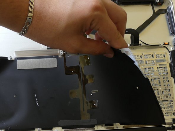

    • Before you do this, BE EXTRA CAREFUL!
    • There is a very thin piece of plastic glued to the keyboard. Start at the edge and slowly lift it from the upper-case as shown in the image.
    • If it tares a little, you will not damage anything too major. But try your best not to let it tare.

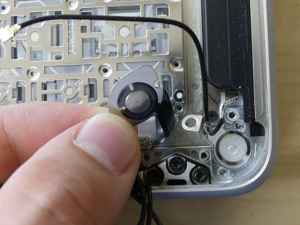

    • Remove the two tiny screws securing the power button.
    • Lift it from of the upper-case.
    • The power button is still connected to the keyboard, don't pull it out completely.
