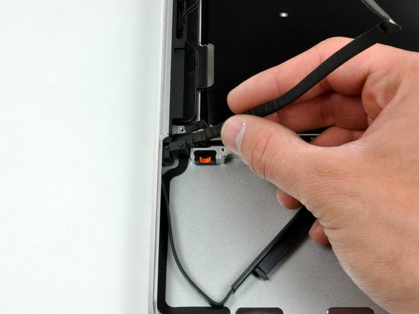

  20. MacBook Unibody Model A1278 Hard Drive Cable Replacement: crwdns2935265:020crwdnd2935265:01crwdnd2935265:02crwdne2935265:0 MacBook Unibody Model A1278 Hard Drive Cable Replacement: crwdns2935265:020crwdnd2935265:02crwdnd2935265:02crwdne2935265:0
    • Peel the hard drive cable from the adhesive securing it to the upper case, and maneuver the plastic retaining block out of the upper case.
    • During reassembly, be sure the two pins on top of the plastic retaining block mate to the holes on the underside of the midwall.
