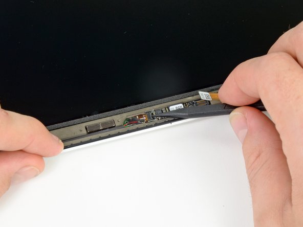

  25. MacBook Unibody Model A1278 Camera Board Replacement, Camera Board: crwdns2935265:025crwdnd2935265:01crwdnd2935265:01crwdne2935265:0
    • Use the flat end of a spudger to pry the iSight cable connector off its socket on the camera board.
  26. MacBook Unibody Model A1278 Camera Board Replacement: crwdns2935265:026crwdnd2935265:01crwdnd2935265:02crwdne2935265:0 MacBook Unibody Model A1278 Camera Board Replacement: crwdns2935265:026crwdnd2935265:02crwdnd2935265:02crwdne2935265:0
    • If the AirPort & iSight data cable was accidentally disconnected while lifting the front display glass from the display assembly, skip this step.
    • If present, use the tip of a spudger to remove the piece of foam tape over the AirPort & iSight data cable ZIF socket.
    • Use the tip of a spudger to flip up the ZIF cable retainer on the camera cable socket.

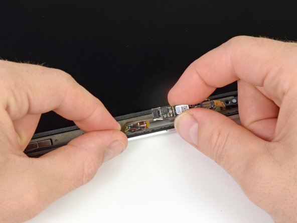

  27. MacBook Unibody Model A1278 Camera Board Replacement: crwdns2935265:027crwdnd2935265:01crwdnd2935265:02crwdne2935265:0 MacBook Unibody Model A1278 Camera Board Replacement: crwdns2935265:027crwdnd2935265:02crwdnd2935265:02crwdne2935265:0
    • Pull the AirPort & iSight cable straight out of its socket on the camera board.
    • Lift and remove the camera board out of the display assembly.
