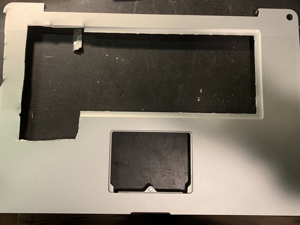

    4. MacBook Pro Screen Conversion, Cutting the Topcase to shape: crwdns2935265:04crwdnd2935265:01crwdnd2935265:03crwdne2935265:0 MacBook Pro Screen Conversion, Cutting the Topcase to shape: crwdns2935265:04crwdnd2935265:02crwdnd2935265:03crwdne2935265:0 MacBook Pro Screen Conversion, Cutting the Topcase to shape: crwdns2935265:04crwdnd2935265:03crwdnd2935265:03crwdne2935265:0

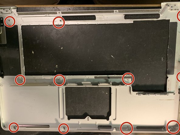

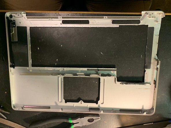

      • You'll be mounting the 3 components to the bottom-access-panel of the old Mac's housing. Before this can be done, you'll need to identify what metal needs to be removed to allow for the 3 components to physically fit.
      • Using your Tin Snips, or a saw: Cut out space for the video control board to be mounted.

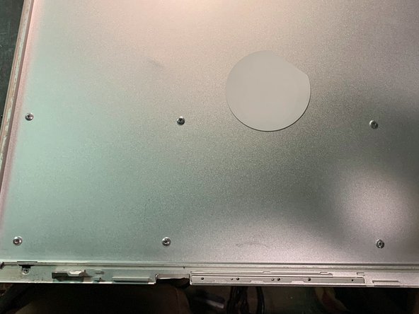

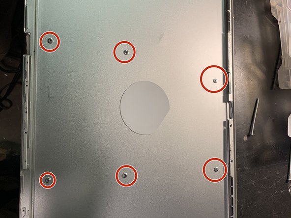

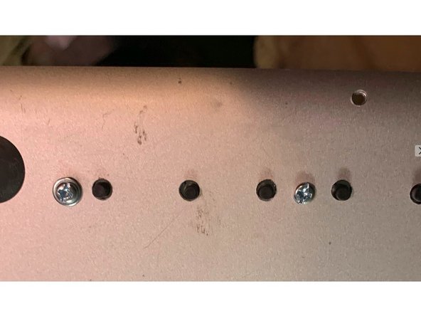

      • Identify good places for your rivets
      • Drill the holes, then rivet the topcase to the back of the metal LCD panel
      • We're using aluminum pop-rivets because of their low profile. There is only a tiny bit of clearance between the back of the LCD, and the surface of the metal housing.

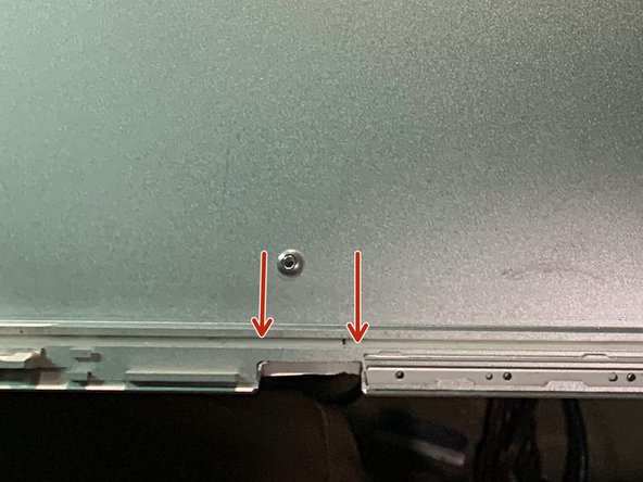

    6. MacBook Pro Screen Conversion, Cutting the frame where the display cable plugs into the LCD: crwdns2935265:06crwdnd2935265:01crwdnd2935265:03crwdne2935265:0 MacBook Pro Screen Conversion, Cutting the frame where the display cable plugs into the LCD: crwdns2935265:06crwdnd2935265:02crwdnd2935265:03crwdne2935265:0 MacBook Pro Screen Conversion, Cutting the frame where the display cable plugs into the LCD: crwdns2935265:06crwdnd2935265:03crwdnd2935265:03crwdne2935265:0
      • Cut a notch in the LCD housing, wide enough for the LCD to plug into the video cable.
      • Protip: Make the initial cuts with a saw (red arrows) then clean it up with a metal-file.

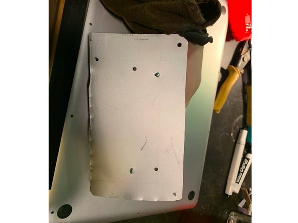

    8. MacBook Pro Screen Conversion, Prepping the Video Control Board: crwdns2935265:08crwdnd2935265:01crwdnd2935265:02crwdne2935265:0 MacBook Pro Screen Conversion, Prepping the Video Control Board: crwdns2935265:08crwdnd2935265:02crwdnd2935265:02crwdne2935265:0

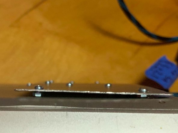

      • Cut a piece of scrap metal so it's large enough to overlap over the edges of the hole you cut in the previous step. (as a rule of thumb: the edges of the scrap metal should extend at least 25mm past each edge of your video control board)
      • Mount your Video Control Board to the scrap metal, using your choice of nuts+bolts or pop rivets.
      • Protip: Stick 2 layers of EVA sticky-backed craft foam onto the back of the circuit board prior to riveting the board to the metal. This prevents the board from shorting out against the metal.
    9. MacBook Pro Screen Conversion, Mounting the video control board: crwdns2935265:09crwdnd2935265:01crwdnd2935265:02crwdne2935265:0 MacBook Pro Screen Conversion, Mounting the video control board: crwdns2935265:09crwdnd2935265:02crwdnd2935265:02crwdne2935265:0
      • Using nuts and bolts, mount the video control board onto the main laptop's back panel.
      • The 2nd image shows nuts being used as washers, to hold the scrap metal piece farther out from the main panel, thus guaranteeing the video board will have enough space.

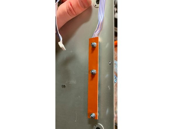

    10. MacBook Pro Screen Conversion, Mounting the Menu Button bar: crwdns2935265:010crwdnd2935265:01crwdnd2935265:03crwdne2935265:0 MacBook Pro Screen Conversion, Mounting the Menu Button bar: crwdns2935265:010crwdnd2935265:02crwdnd2935265:03crwdne2935265:0 MacBook Pro Screen Conversion, Mounting the Menu Button bar: crwdns2935265:010crwdnd2935265:03crwdnd2935265:03crwdne2935265:0
      • Identify where you'd like your menu buttons to be. I've placed mine so they'll be along the left-edge once the project is completed.
      • Drill small holes for your nuts and bolts, and larger holes for the buttons
      • Mount the menu board using nuts and bolts.
      • Protip: Make a note of which button is the POWER button. May come in handy in Step 12. These boards typically have little function labels printed on them.

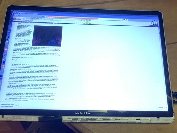

    12. MacBook Pro Screen Conversion, Assemble the unit: crwdns2935265:012crwdnd2935265:01crwdnd2935265:02crwdne2935265:0 MacBook Pro Screen Conversion, Assemble the unit: crwdns2935265:012crwdnd2935265:02crwdnd2935265:02crwdne2935265:0
      • All 3 parts of the Video Control Board are mounted to the macbook's Back Panel. To assemble, simply screw the back panel in place using the Mac's original outer-case screws. Screw in the screen. Replace the self-adhesive glass over the screen.
      • Plug it into any Mac or PC, plug in a power supply, and test to make sure it works
      • No video? You may need to turn it on! Look at that menu button panel from Step 10. Figure out which button is the power button, and press it ONCE. You may need to wait up to 10 seconds for it to come to life for the first time, so don't go repeatedly rapidly pressing buttons.

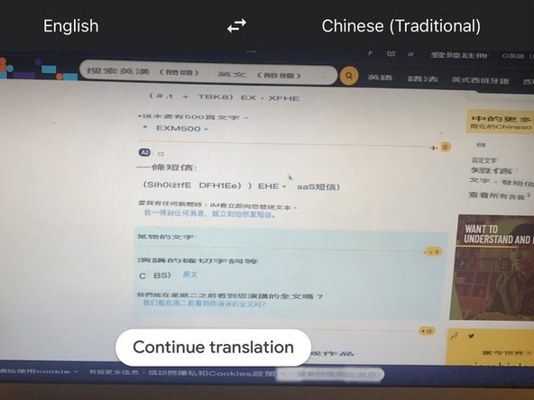

    13. MacBook Pro Screen Conversion, Getting the Menu into English: crwdns2935265:013crwdnd2935265:01crwdnd2935265:02crwdne2935265:0 MacBook Pro Screen Conversion, Getting the Menu into English: crwdns2935265:013crwdnd2935265:02crwdnd2935265:02crwdne2935265:0
      • These things typically come with menus that are in Chinese
      • Download the Google Translate app onto your phone or tablet.
      • Google Translate has a feature where you can point your phone camera at any foreign language text, and it will use text-recognition to identify and translate anything it sees, then superimpose english text over the image, all live in real time. (Pictured: an example of this)
      • Holding your phone over your monitor, navigate the chinese-language menu until you find the language setting. Change your new screen to English! (or whatever your native language is)
