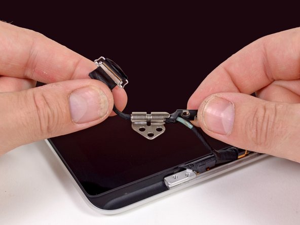

    • The left display hinge comes out with no issues, but good luck separating it from the display data cable.
    • Devices with cables fed through hinges can be a real bear to work on. None of that will be an issue with this machine, though, as the display hinge is pretty much sealed shut at the factory. Rather than routing the cable under a cable retainer -- as it's done in non-Retina MacBook Pros -- you just have to replace both cable and hinge together.
    • Don't think that the guys (and gals) who designed this machine are just out to get you. Routing the cables through the hinge is a way to save space and weight in the laptop.

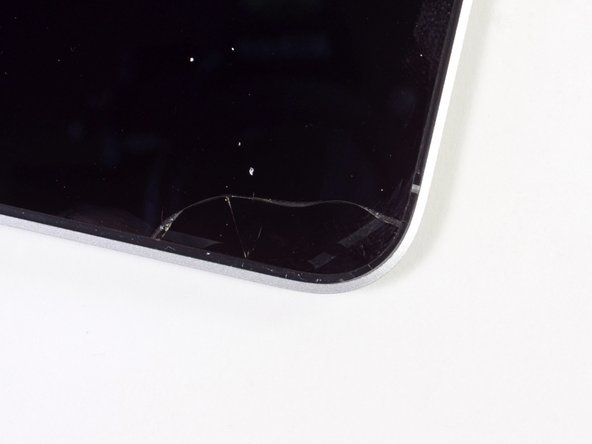

    • Q: What happens when you hand over a groundbreaking notebook display to a group of careful, highly trained technicians?
    • A: They break it.
    • We were as careful as we could possibly be, but the glass on the Retina display is just too fragile.
    • So, how badly did we break it? Well, upon closer inspection we noticed two very distinct lines running around the perimeter of the display, the inner of which was filled with tiny bubbles.
    • Could those be the LCs of our LCD?

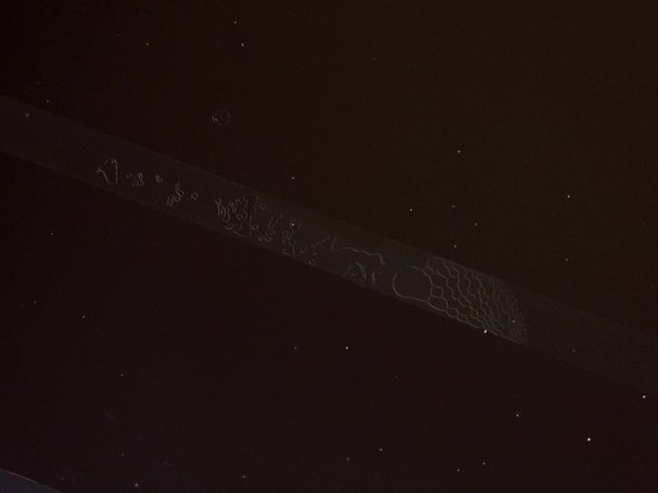

    • The light guide plate is held down by a small strip of mild adhesive—nothing like we saw before.
    • Erring on the side of caution, we proceded very slowly with our modified iSesamo opening tool and removed the plate.
    • Backlight bounces through the plate due to total internal reflection until it hits one of those tiny dots, which sends the light up and out of the front of the plate.
    • By the way, the third picture is an image of the grid found in the clear plastic plate being removed in the second picture. We had to coerce it a bit in Photoshop in order to make it show its grid.

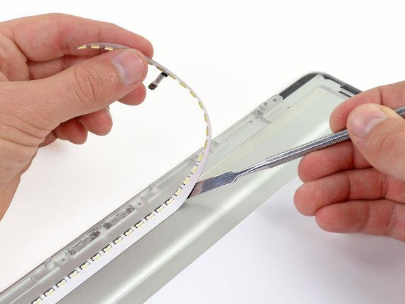

    • The plain-looking sheet of white paper serves as a uniform white background for the LCD's backlight.
    • What else would you use to light an LED-backlit display? LEDs, of course!

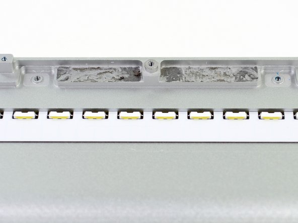

    • A strip of 48 LEDs at the bottom of the display assembly provides all the light your Retina display needs.

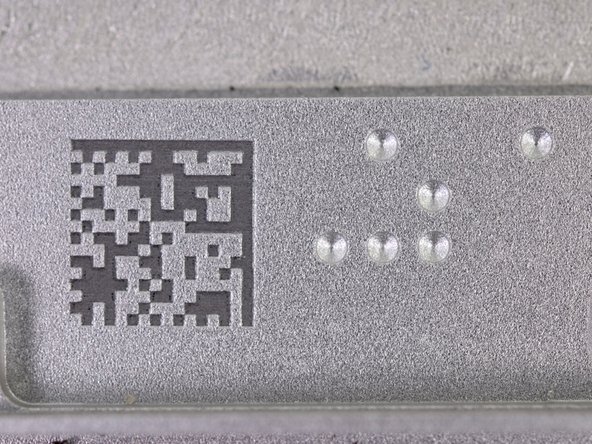

    • The bottom edge of the case has two features that we found pretty neat: a laser engraved data matrix code and a nifty arrangement of round indentations.
    • Upon further inspection and with the help of some keen-eyed readers, it appears that those dots form the pattern of a glider from Conway's Game of Life, the universal symbol for hackers.
    • That sixth dot to the right, though? Apparently, if you were to place that dot while playing, it would lead the glider into a state of death. Is Apple trying to send us a message?
