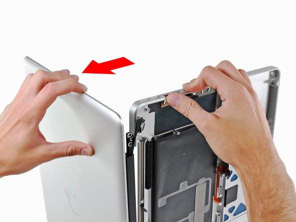

MacBook Pro 17" Unibody Upper Case Replacement
  1. MacBook Pro 17" Unibody Upper Case Replacement, Lower Case: crwdns2935265:01crwdnd2935265:01crwdnd2935265:01crwdne2935265:0
    • Seven 3 mm Phillips screws.
  2. MacBook Pro 17" Unibody Upper Case Replacement: crwdns2935265:02crwdnd2935265:01crwdnd2935265:02crwdne2935265:0 MacBook Pro 17" Unibody Upper Case Replacement: crwdns2935265:02crwdnd2935265:02crwdnd2935265:02crwdne2935265:0
    • Wedge your fingers between the lower case and the vent, and lift upward to release the two clips holding the lower case to the upper case.
    • During reassembly, carefully align the lower case and then press it firmly until both clips engage.
    • Remove the lower case.
  3. MacBook Pro 17" Unibody Upper Case Replacement, Battery: crwdns2935265:03crwdnd2935265:01crwdnd2935265:03crwdne2935265:0 MacBook Pro 17" Unibody Upper Case Replacement, Battery: crwdns2935265:03crwdnd2935265:02crwdnd2935265:03crwdne2935265:0 MacBook Pro 17" Unibody Upper Case Replacement, Battery: crwdns2935265:03crwdnd2935265:03crwdnd2935265:03crwdne2935265:0
    • Whenever working near the logic board, it is always wise to first disconnect the battery to avoid short circuits.
    • If present, grab the plastic tab attached to the battery connector and pull it toward the front edge of the device. For Late-2011 models the battery connector will not have a tab and is simply a plug that inserts straight down into the motherboard--to remove pry the plug straight up.
    • If the plastic tab is missing, use a spudger to pry the connector up from its socket.
    • Pull the tab parallel to the face of the logic board.
  4. MacBook Pro 17" Unibody Upper Case Replacement, Right Fan: crwdns2935265:04crwdnd2935265:01crwdnd2935265:03crwdne2935265:0 MacBook Pro 17" Unibody Upper Case Replacement, Right Fan: crwdns2935265:04crwdnd2935265:02crwdnd2935265:03crwdne2935265:0 MacBook Pro 17" Unibody Upper Case Replacement, Right Fan: crwdns2935265:04crwdnd2935265:03crwdnd2935265:03crwdne2935265:0
    • Use the flat end of a spudger to lift the right fan connector out of its socket on the logic board.
    • It is useful to twist the spudger axially from beneath the fan cable wires to release the connector.
    • The fan socket and the fan connector can be seen in the second and third pictures. Be careful not to break the plastic fan socket off the logic board as you use your spudger to lift the fan connector straight up and out of its socket. The layout of the logic board shown in the second picture may look slightly different than your machine but the fan socket is the same.
  5. MacBook Pro 17" Unibody Upper Case Replacement: crwdns2935265:05crwdnd2935265:01crwdnd2935265:01crwdne2935265:0
    • Remove the three 3.1 mm Phillips screws securing the right fan to the logic board.
    • In the Late 2011 MacBook Pro 17" Unibody these screws will be T6 Torx.
  6. MacBook Pro 17" Unibody Upper Case Replacement: crwdns2935265:06crwdnd2935265:01crwdnd2935265:01crwdne2935265:0
    • Remove the right fan from the upper case, minding its cable that may get caught.
  7. MacBook Pro 17" Unibody Upper Case Replacement, Logic Board: crwdns2935265:07crwdnd2935265:01crwdnd2935265:01crwdne2935265:0
    • Use the flat end of a spudger to lift the left fan connector out of its socket on the logic board.
  8. MacBook Pro 17" Unibody Upper Case Replacement: crwdns2935265:08crwdnd2935265:01crwdnd2935265:02crwdne2935265:0 MacBook Pro 17" Unibody Upper Case Replacement: crwdns2935265:08crwdnd2935265:02crwdnd2935265:02crwdne2935265:0
    • Remove the three 3.1 mm Phillips screws securing the left fan to the logic board.
    • Remove the left fan from the upper case, minding its cable that may get caught.
  9. MacBook Pro 17" Unibody Upper Case Replacement: crwdns2935265:09crwdnd2935265:01crwdnd2935265:02crwdne2935265:0 MacBook Pro 17" Unibody Upper Case Replacement: crwdns2935265:09crwdnd2935265:02crwdnd2935265:02crwdne2935265:0
    • Use the tip of a spudger or your fingernail to flip up the retaining flap on the keyboard backlight ribbon cable.
    • Be sure you are prying up on the retaining flap, not the socket itself.
    • Pull the keyboard backlight ribbon cable out of its socket.
  10. MacBook Pro 17" Unibody Upper Case Replacement: crwdns2935265:010crwdnd2935265:01crwdnd2935265:01crwdne2935265:0
    • Before disconnecting the camera cable, a small plastic retainer stuck to the logic board must first be moved out of the way.
    • Use the tip of a spudger to push the small plastic cable retainer away from the camera cable socket for enough clearance to remove the camera cable.
  11. MacBook Pro 17" Unibody Upper Case Replacement: crwdns2935265:011crwdnd2935265:01crwdnd2935265:01crwdne2935265:0
    • Pull the camera cable toward the optical drive opening to disconnect it from the logic board.
    • The camera cable socket is very fragile. Do not apply any upward force to this socket, as it may break off the logic board. Pull the camera cable parallel to the face of the logic board.
  12. MacBook Pro 17" Unibody Upper Case Replacement: crwdns2935265:012crwdnd2935265:01crwdnd2935265:01crwdne2935265:0
    • Use the flat end of a spudger to pry the optical drive connector up and out of its socket on the logic board.
  13. MacBook Pro 17" Unibody Upper Case Replacement: crwdns2935265:013crwdnd2935265:01crwdnd2935265:01crwdne2935265:0
    • Use the flat end of a spudger to lift the subwoofer & right speaker connector out of its socket on the logic board.
    • Pry up from beneath the wires.
  14. MacBook Pro 17" Unibody Upper Case Replacement: crwdns2935265:014crwdnd2935265:01crwdnd2935265:02crwdne2935265:0 MacBook Pro 17" Unibody Upper Case Replacement: crwdns2935265:014crwdnd2935265:02crwdnd2935265:02crwdne2935265:0
    • Use the tip of a spudger or your fingernail to flip up the retaining flap on the IR sensor ribbon cable socket.
    • Pull the IR sensor ribbon cable out of its socket.
  15. MacBook Pro 17" Unibody Upper Case Replacement: crwdns2935265:015crwdnd2935265:01crwdnd2935265:03crwdne2935265:0 MacBook Pro 17" Unibody Upper Case Replacement: crwdns2935265:015crwdnd2935265:02crwdnd2935265:03crwdne2935265:0 MacBook Pro 17" Unibody Upper Case Replacement: crwdns2935265:015crwdnd2935265:03crwdnd2935265:03crwdne2935265:0
    • Remove the following four screws:
    • Two 3.5 mm Phillips screws
    • These may be T5 Torx screws in the Early 2011 model
    • Two 1.6 mm Phillips screws
    • Remove both connector shields from the logic board.
  16. MacBook Pro 17" Unibody Upper Case Replacement: crwdns2935265:016crwdnd2935265:01crwdnd2935265:01crwdne2935265:0
    • Use the flat end of a spudger to pry the trackpad connector up and out of its socket on the logic board.
  17. MacBook Pro 17" Unibody Upper Case Replacement: crwdns2935265:017crwdnd2935265:01crwdnd2935265:02crwdne2935265:0 MacBook Pro 17" Unibody Upper Case Replacement: crwdns2935265:017crwdnd2935265:02crwdnd2935265:02crwdne2935265:0
    • Use your fingernail to flip up the retaining flap on the keyboard ribbon cable socket.
    • Pull the keyboard ribbon cable out of its socket.
    • For reassembly, it can be helpful to put a small piece of tape on the keyboard ribbon cable (being careful not to stick any to the contacts), to create a small handle. Align the cable with the socket and gently pull with the tape to fully seat it.
  18. MacBook Pro 17" Unibody Upper Case Replacement: crwdns2935265:018crwdnd2935265:01crwdnd2935265:02crwdne2935265:0 MacBook Pro 17" Unibody Upper Case Replacement: crwdns2935265:018crwdnd2935265:02crwdnd2935265:02crwdne2935265:0
    • Use your fingernail to flip up the retaining flap on the express card cage ribbon cable socket.
    • Pull the express card cage ribbon cable out of its socket.
  19. MacBook Pro 17" Unibody Upper Case Replacement: crwdns2935265:019crwdnd2935265:01crwdnd2935265:01crwdne2935265:0
    • Use the flat end of a spudger to lift the hard drive cable connector up and out of its socket on the logic board.
  20. MacBook Pro 17" Unibody Upper Case Replacement: crwdns2935265:020crwdnd2935265:01crwdnd2935265:02crwdne2935265:0 MacBook Pro 17" Unibody Upper Case Replacement: crwdns2935265:020crwdnd2935265:02crwdnd2935265:02crwdne2935265:0
    • Use the tip of a spudger or your fingernail to flip up the retaining flap on the battery indicator cable socket.
    • Pull the battery indicator ribbon cable out of its socket.
  21. MacBook Pro 17" Unibody Upper Case Replacement: crwdns2935265:021crwdnd2935265:01crwdnd2935265:03crwdne2935265:0 MacBook Pro 17" Unibody Upper Case Replacement: crwdns2935265:021crwdnd2935265:02crwdnd2935265:03crwdne2935265:0 MacBook Pro 17" Unibody Upper Case Replacement: crwdns2935265:021crwdnd2935265:03crwdnd2935265:03crwdne2935265:0
    • Lift the black plastic flap attached to the display data cable retainer and rotate it toward the DC-In side of the MacBook.
    • Pull the display data cable out of its socket.
    • The display data cable socket is very fragile. Do not lift the connector upward as you disconnect it, as the socket may break off the logic board. Pull the cable parallel to the face of the logic board.
  22. MacBook Pro 17" Unibody Upper Case Replacement: crwdns2935265:022crwdnd2935265:01crwdnd2935265:01crwdne2935265:0
    • Remove the following eight screws securing the logic board and DC-In board to the upper case:
    • Six 3.2 mm Phillips screws
    • These may be T6 Torx screws on the Early 2011 model.
    • Two 7.6 mm Phillips screws
  23. MacBook Pro 17" Unibody Upper Case Replacement: crwdns2935265:023crwdnd2935265:01crwdnd2935265:02crwdne2935265:0 MacBook Pro 17" Unibody Upper Case Replacement: crwdns2935265:023crwdnd2935265:02crwdnd2935265:02crwdne2935265:0
    • Handle the logic board assembly by its edges only.
    • Lift the logic board assembly from the side nearest the optical drive and lift it away from the upper case.
    • Note that you'll be removing the logic board and DC-in board together.
    • Carefully pull the ports and DC-In board away from the side of the upper case and remove the logic board assembly, minding any cables that may get caught.
  24. MacBook Pro 17" Unibody Upper Case Replacement, Express Card Cage: crwdns2935265:024crwdnd2935265:01crwdnd2935265:02crwdne2935265:0 MacBook Pro 17" Unibody Upper Case Replacement, Express Card Cage: crwdns2935265:024crwdnd2935265:02crwdnd2935265:02crwdne2935265:0
    • Remove the two Phillips screws securing the hard drive bracket to the upper case.
    • Both screws are captive to the hard drive bracket.
    • Remove the hard drive bracket from the upper case.
  25. MacBook Pro 17" Unibody Upper Case Replacement: crwdns2935265:025crwdnd2935265:01crwdnd2935265:01crwdne2935265:0
    • Peel the hard drive and battery indicator cables off the adhesive securing them to the express card cage.
  26. MacBook Pro 17" Unibody Upper Case Replacement: crwdns2935265:026crwdnd2935265:01crwdnd2935265:01crwdne2935265:0
    • Remove the following five screws securing the express card cage to the upper case:
    • Three 2 mm Phillips screws
    • Two 4 mm Phillips screws
  27. MacBook Pro 17" Unibody Upper Case Replacement: crwdns2935265:027crwdnd2935265:01crwdnd2935265:01crwdne2935265:0
    • Remove the express card cage from the upper case.
  28. MacBook Pro 17" Unibody Upper Case Replacement, Upper Case: crwdns2935265:028crwdnd2935265:01crwdnd2935265:01crwdne2935265:0

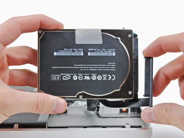

    • Using its attached pull tab, lift the hard drive out of the upper case.
    • Do not try to completely remove the hard drive just yet! The hard drive cable is still attached to the upper case.
  29. MacBook Pro 17" Unibody Upper Case Replacement: crwdns2935265:029crwdnd2935265:01crwdnd2935265:02crwdne2935265:0 MacBook Pro 17" Unibody Upper Case Replacement: crwdns2935265:029crwdnd2935265:02crwdnd2935265:02crwdne2935265:0
    • Pull the hard drive cable connector away from the body of the hard drive.
    • Remove the hard drive from the upper case and set it aside.

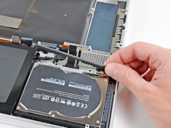

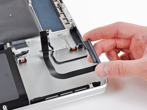

  30. MacBook Pro 17" Unibody Upper Case Replacement: crwdns2935265:030crwdnd2935265:01crwdnd2935265:02crwdne2935265:0 MacBook Pro 17" Unibody Upper Case Replacement: crwdns2935265:030crwdnd2935265:02crwdnd2935265:02crwdne2935265:0
    • Remove the two 2.2 mm Phillips screws securing the hard drive cable to the upper case.
    • Remove the hard drive cable from the upper case.
  31. MacBook Pro 17" Unibody Upper Case Replacement: crwdns2935265:031crwdnd2935265:01crwdnd2935265:02crwdne2935265:0 MacBook Pro 17" Unibody Upper Case Replacement: crwdns2935265:031crwdnd2935265:02crwdnd2935265:02crwdne2935265:0
    • Remove the two 10 mm Phillips screws securing the front hard drive bracket to the upper case.
    • Remove the front hard drive bracket.

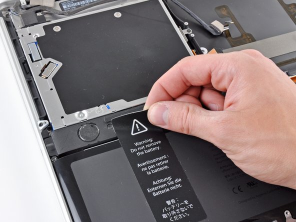

  32. MacBook Pro 17" Unibody Upper Case Replacement: crwdns2935265:032crwdnd2935265:01crwdnd2935265:02crwdne2935265:0 MacBook Pro 17" Unibody Upper Case Replacement: crwdns2935265:032crwdnd2935265:02crwdnd2935265:02crwdne2935265:0
    • Use an iPod opening tool or another soft thin-edged tool to carefully lift up a corner of the "Warning: Do not remove the battery" sticker off the right speaker/subwoofer enclosure.
    • Peel the sticker off the right speaker/subwoofer enclosure.
    • It is not necessary to peel the sticker off the battery.

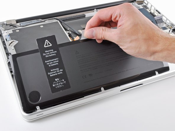

  33. MacBook Pro 17" Unibody Upper Case Replacement: crwdns2935265:033crwdnd2935265:01crwdnd2935265:02crwdne2935265:0 MacBook Pro 17" Unibody Upper Case Replacement: crwdns2935265:033crwdnd2935265:02crwdnd2935265:02crwdne2935265:0
    • Remove the three 6.5 mm Tri-point screws securing the battery to the upper case.
    • Using its attached pull tab, lift the battery out of the upper case.
  34. MacBook Pro 17" Unibody Upper Case Replacement: crwdns2935265:034crwdnd2935265:01crwdnd2935265:01crwdne2935265:0
    • Carefully disconnect the Bluetooth cable from the Bluetooth board.
    • Pull the cable parallel to the face of the optical drive toward the port openings.
  35. MacBook Pro 17" Unibody Upper Case Replacement: crwdns2935265:035crwdnd2935265:01crwdnd2935265:01crwdne2935265:0
    • Use the flat end of a spudger to peel the thin plastic cover off the top and sides of the Bluetooth board housing.
  36. MacBook Pro 17" Unibody Upper Case Replacement: crwdns2935265:036crwdnd2935265:01crwdnd2935265:01crwdne2935265:0
    • Use the flat end of a spudger to pry the Bluetooth antenna connector up and off its socket on the Bluetooth board.
  37. MacBook Pro 17" Unibody Upper Case Replacement: crwdns2935265:037crwdnd2935265:01crwdnd2935265:01crwdne2935265:0
    • Remove the small piece of EMI foam attached near the Bluetooth board.
  38. MacBook Pro 17" Unibody Upper Case Replacement: crwdns2935265:038crwdnd2935265:01crwdnd2935265:01crwdne2935265:0
    • Remove the three 3.5 mm Phillips screws securing the optical drive to the upper case.
    • To remove the screw closest to the battery, it may be helpful to use a T6 Torx screwdriver to first remove the upper case bracket directly above it.
  39. MacBook Pro 17" Unibody Upper Case Replacement: crwdns2935265:039crwdnd2935265:01crwdnd2935265:01crwdne2935265:0
    • Remove the optical drive assembly from the upper case.
  40. MacBook Pro 17" Unibody Upper Case Replacement: crwdns2935265:040crwdnd2935265:01crwdnd2935265:01crwdne2935265:0

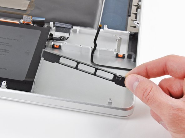

    • Remove the following three screws securing the subwoofer & right speaker to the upper case:
    • One 2.6 mm Phillips screw
    • Two 12.3 mm Phillips screws
  41. MacBook Pro 17" Unibody Upper Case Replacement: crwdns2935265:041crwdnd2935265:01crwdnd2935265:01crwdne2935265:0
    • Remove the subwoofer and right speaker assembly from the upper case.

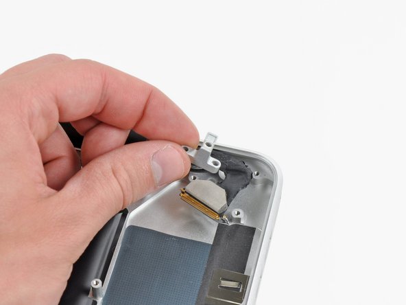

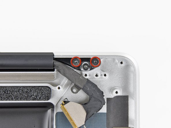

  42. MacBook Pro 17" Unibody Upper Case Replacement: crwdns2935265:042crwdnd2935265:01crwdnd2935265:02crwdne2935265:0 MacBook Pro 17" Unibody Upper Case Replacement: crwdns2935265:042crwdnd2935265:02crwdnd2935265:02crwdne2935265:0

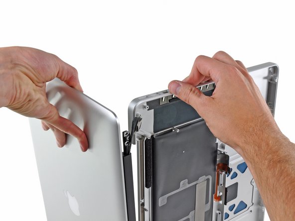

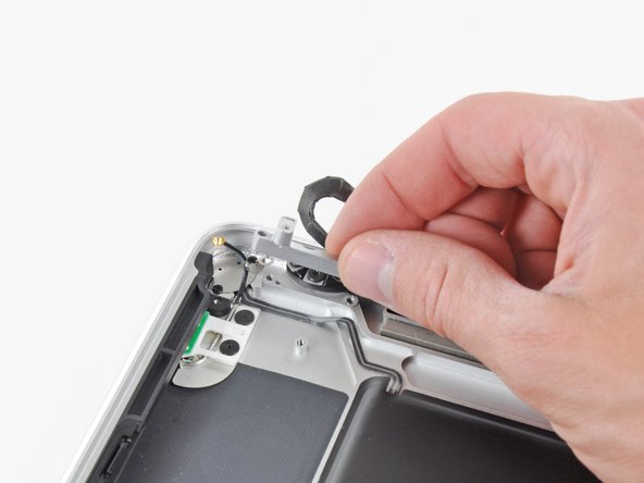

    • Remove the two 7.1 mm Phillips screws securing the camera cable retainer to the upper case.
    • Remove the camera cable retainer from the upper case.

    • Remove the two 7.1 mm Phillips screws securing the display data cable retainer to the upper case.
    • Remove the display data cable retainer.

    • Remove the two outer 6.8 mm T6 Torx screws from each of the two display brackets (four screws total).
    • We purposely have you leave one screw attaching each display bracket to the upper case to aid in future steps.

    • Open your MacBook Pro so the display is perpendicular to the upper case.
    • Place your opened MacBook Pro on a table as pictured.
    • While holding the display and upper case together with your left hand, remove the remaining T6 Torx screw from the lower display bracket.
  46. MacBook Pro 17" Unibody Upper Case Replacement: crwdns2935265:046crwdnd2935265:01crwdnd2935265:01crwdne2935265:0
    • Be sure to hold the display and upper case together with your left hand. Failure to do so may cause the freed display/upper case to fall, potentially damaging each component.
    • Remove the last remaining T6 Torx screw securing the display to the upper case.
  47. MacBook Pro 17" Unibody Upper Case Replacement: crwdns2935265:047crwdnd2935265:01crwdnd2935265:03crwdne2935265:0 MacBook Pro 17" Unibody Upper Case Replacement: crwdns2935265:047crwdnd2935265:02crwdnd2935265:03crwdne2935265:0 MacBook Pro 17" Unibody Upper Case Replacement: crwdns2935265:047crwdnd2935265:03crwdnd2935265:03crwdne2935265:0
    • Grab the upper case with your right hand and rotate it slightly toward the top of the display so the upper display bracket clears the edge of the upper case.
    • Rotate the display slightly away from the upper case.
    • Lift the display up and away from the upper case, minding any brackets or cables that may get caught.
To reassemble your device, follow these instructions in reverse order. Make sure that any ribbon cables which need to be attached to the logic board are above it and free from getting caught before you screw it into place.
