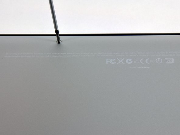

    • The lower case. Apple's using wide, thin black rubber feet on the Unibody Pros, a departure from the small stubby bumpers on the Aluminum revisions.
    • There are ten Phillips screws around the perimeter of the lower case to remove:
    • Seven 3 mm screws
    • Three 14 mm screws
    • Apple's user manual for this computer has instructions to remove the lower case. But they got the length of one of the screws wrong. We promise to get them right in our repair guide.
    • The computer's serial number is engraved in the aluminum lower case, not the upper case like the other Unibody machines.

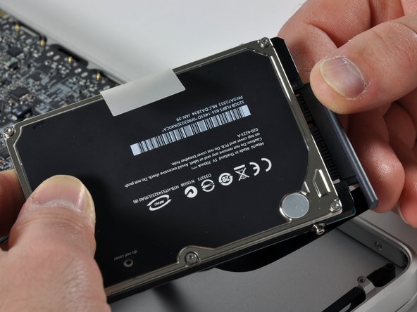

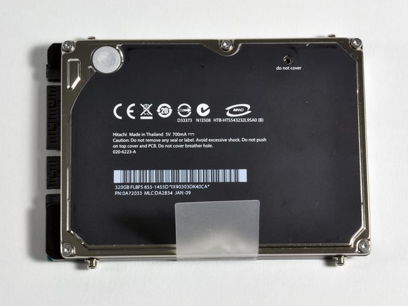

  8. MacBook Pro 17" Unibody Teardown: crwdns2935265:08crwdnd2935265:01crwdnd2935265:03crwdne2935265:0 MacBook Pro 17" Unibody Teardown: crwdns2935265:08crwdnd2935265:02crwdnd2935265:03crwdne2935265:0 MacBook Pro 17" Unibody Teardown: crwdns2935265:08crwdnd2935265:03crwdnd2935265:03crwdne2935265:0
    • To remove the hard drive, unscrew the two small Phillips screws holding the black plastic hard drive bracket to the chassis. Pull up on the white plastic tab and lift the hard drive out of the case, being careful not to strain the SATA cable.
    • Carefully disconnect the Serial ATA cable.

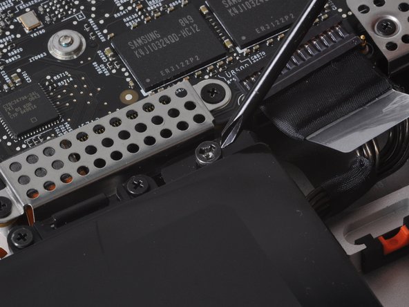

    • Ignoring all manufacturer warnings, we are removing the non-removable battery. Hold your breath!
    • There are three tri-wing screws holding the battery to the Unibody case.

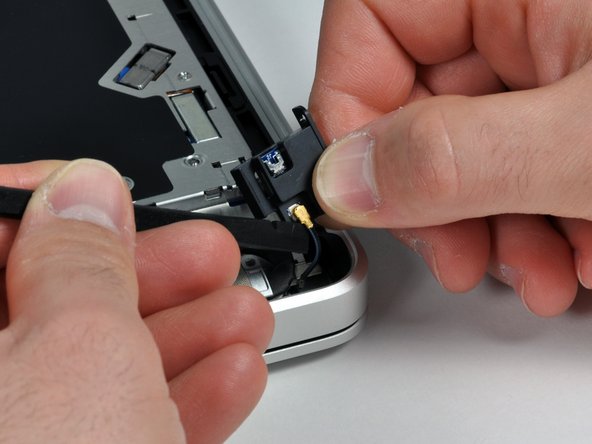

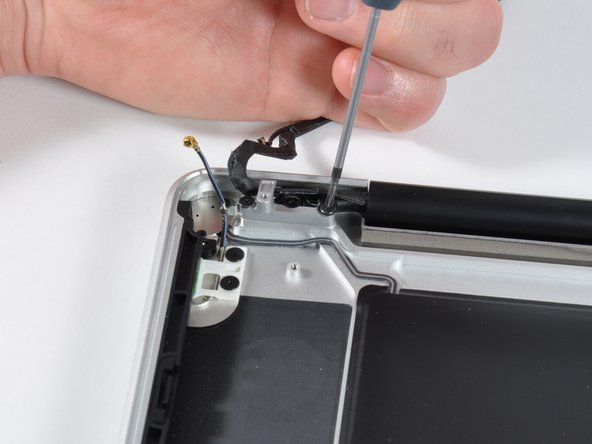

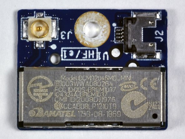

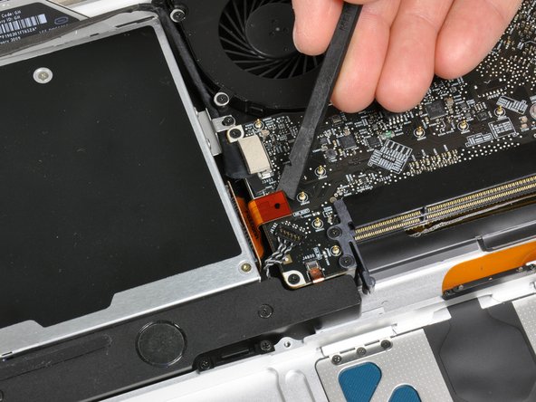

  11. MacBook Pro 17" Unibody Teardown: crwdns2935265:011crwdnd2935265:01crwdnd2935265:03crwdne2935265:0 MacBook Pro 17" Unibody Teardown: crwdns2935265:011crwdnd2935265:02crwdnd2935265:03crwdne2935265:0 MacBook Pro 17" Unibody Teardown: crwdns2935265:011crwdnd2935265:03crwdnd2935265:03crwdne2935265:0
    • The Bluetooth board is right behind the optical drive, next to the hinge.
    • It's very nice that Apple moved this out of the display assembly (where it is located in the MacBook Unibody and 15" MacBook Pro Unibody). No longer does a Unibody owner need to replace their entire display assembly ($$$) when their Bluetooth goes out.
    • It has an Anatel logo on it: BCM93046MD MINI 003WWA080264 FCC iD:QDS-BRCM1037.
    • Like the other Unibody machines, the Airport card is in the display assembly clutch cover.

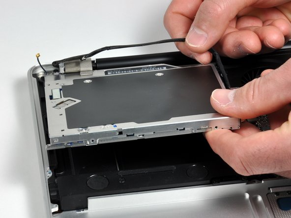

  12. MacBook Pro 17" Unibody Teardown: crwdns2935265:012crwdnd2935265:01crwdnd2935265:03crwdne2935265:0 MacBook Pro 17" Unibody Teardown: crwdns2935265:012crwdnd2935265:02crwdnd2935265:03crwdne2935265:0 MacBook Pro 17" Unibody Teardown: crwdns2935265:012crwdnd2935265:03crwdnd2935265:03crwdne2935265:0
    • The 8x slot-loading SuperDrive (DVD±R DL/DVD±RW/CD-RW).
    • The internal design of this machine is pretty consistent with the 15" MacBook Pro. We'll be posting some part comparison shots later to show relative sizing.

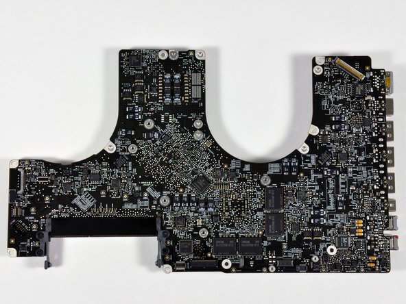

  13. MacBook Pro 17" Unibody Teardown: crwdns2935265:013crwdnd2935265:01crwdnd2935265:01crwdne2935265:0
    • The bottom of the logic board.
    • The component density is amazing.
    • There are four Samsung K4J10324QD-HC12 chips, likely video RAM for the NVidia 9600 chipset.

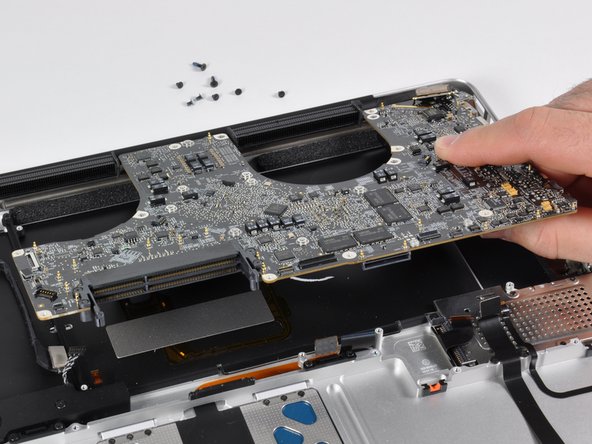

  17. MacBook Pro 17" Unibody Teardown: crwdns2935265:017crwdnd2935265:01crwdnd2935265:02crwdne2935265:0 MacBook Pro 17" Unibody Teardown: crwdns2935265:017crwdnd2935265:02crwdnd2935265:02crwdne2935265:0
    • The logic board with all connectors removed.
    • Remove the following eight screws:
    • Six 3 mm Phillips from the logic board
    • Two 7.2 mm Phillips from the MagSafe board
    • Second image: removing logic board.

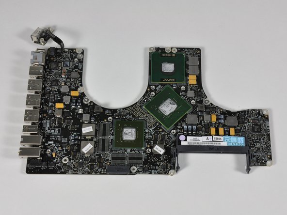

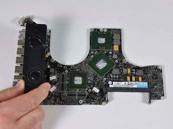

  18. MacBook Pro 17" Unibody Teardown: crwdns2935265:018crwdnd2935265:01crwdnd2935265:01crwdne2935265:0
    • Top of logic board.
    • The speakers are mounted on the left next to the ports.
    • The heat sink covers the two NVidia chipsets and the processor.
    • This machine has 512 MB video memory for the NVidia 9600M. The 9400M chipset shares 256 MB of system memory. You have to log out to switch between graphics chipsets.

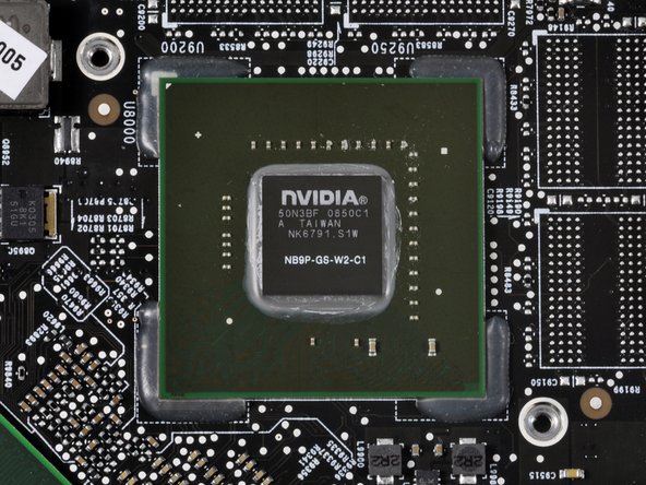

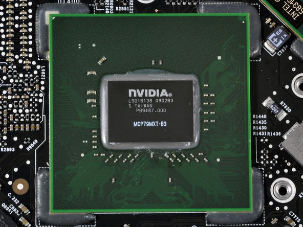

  20. MacBook Pro 17" Unibody Teardown: crwdns2935265:020crwdnd2935265:01crwdnd2935265:03crwdne2935265:0 MacBook Pro 17" Unibody Teardown: crwdns2935265:020crwdnd2935265:02crwdnd2935265:03crwdne2935265:0 MacBook Pro 17" Unibody Teardown: crwdns2935265:020crwdnd2935265:03crwdnd2935265:03crwdne2935265:0
    • We removed the heat sink thermal compound so you can see the die markings.
    • Left image: Intel processor. No die markings!
    • Middle image: NVidia L901B138 0902B3 PB9487.000 MCP79MXT-B3
    • Right Image: NVidia 50N3BF 0850C1 NK6791.S1W NB9P-GS-W2-C1

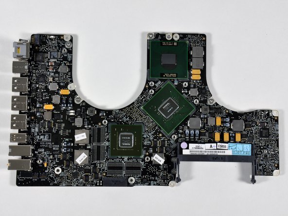

  21. MacBook Pro 17" Unibody Teardown: crwdns2935265:021crwdnd2935265:01crwdnd2935265:03crwdne2935265:0 MacBook Pro 17" Unibody Teardown: crwdns2935265:021crwdnd2935265:02crwdnd2935265:03crwdne2935265:0 MacBook Pro 17" Unibody Teardown: crwdns2935265:021crwdnd2935265:03crwdnd2935265:03crwdne2935265:0
    • Left: 15" Unibody logic board
    • Right: 17" Unibody logic board
    • What's different? The biggest difference to you is the additional USB port. Oh, and $800.
    • The low-end 15" board that we took apart in October only has 256 MB video memory (Samsung RAM soldered onto the board). The high-end 15" and this 17" have 512 MB video RAM.

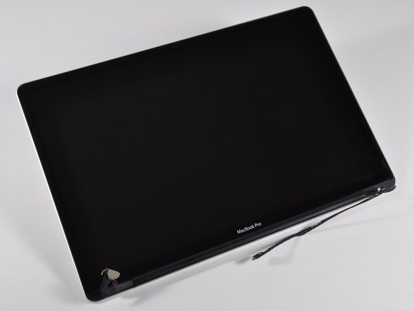

  23. MacBook Pro 17" Unibody Teardown: crwdns2935265:023crwdnd2935265:01crwdnd2935265:03crwdne2935265:0 MacBook Pro 17" Unibody Teardown: crwdns2935265:023crwdnd2935265:02crwdnd2935265:03crwdne2935265:0 MacBook Pro 17" Unibody Teardown: crwdns2935265:023crwdnd2935265:03crwdnd2935265:03crwdne2935265:0
    • We removed the display assembly.
    • Here we have the 13", 15", and 17" MacBook displays stacked together.
