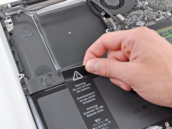

  14. MacBook Pro 17" Unibody Subwoofer & Right Speaker Replacement: crwdns2935265:014crwdnd2935265:01crwdnd2935265:02crwdne2935265:0 MacBook Pro 17" Unibody Subwoofer & Right Speaker Replacement: crwdns2935265:014crwdnd2935265:02crwdnd2935265:02crwdne2935265:0
    • Use an iPod opening tool or another soft thin-edged tool to carefully lift up a corner of the "Warning: Do not remove the battery" sticker off the right speaker/subwoofer enclosure.
    • Peel the sticker off the right speaker/subwoofer enclosure.
    • It is not necessary to peel the sticker off the battery.
