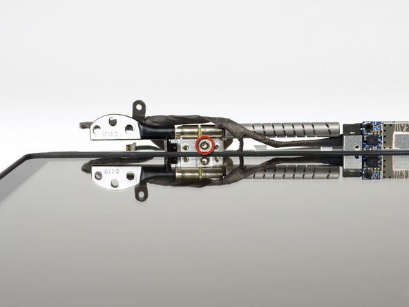

  14. MacBook Pro 17" Unibody Right Clutch Hinge Replacement: crwdns2935265:014crwdnd2935265:01crwdnd2935265:01crwdne2935265:0
    • Open your MacBook Pro so the display is perpendicular to the upper case.
    • Place your opened MacBook Pro on a table as pictured.
    • While holding the display and upper case together with your left hand, remove the remaining T6 Torx screw from the lower display bracket.
  15. MacBook Pro 17" Unibody Right Clutch Hinge Replacement: crwdns2935265:015crwdnd2935265:01crwdnd2935265:01crwdne2935265:0
    • Be sure to hold the display and upper case together with your left hand. Failure to do so may cause the freed display/upper case to fall, potentially damaging each component.
    • Remove the last remaining T6 Torx screw securing the display to the upper case.
  16. MacBook Pro 17" Unibody Right Clutch Hinge Replacement: crwdns2935265:016crwdnd2935265:01crwdnd2935265:03crwdne2935265:0 MacBook Pro 17" Unibody Right Clutch Hinge Replacement: crwdns2935265:016crwdnd2935265:02crwdnd2935265:03crwdne2935265:0 MacBook Pro 17" Unibody Right Clutch Hinge Replacement: crwdns2935265:016crwdnd2935265:03crwdnd2935265:03crwdne2935265:0
    • Grab the upper case with your right hand and rotate it slightly toward the top of the display so the upper display bracket clears the edge of the upper case.
    • Rotate the display slightly away from the upper case.
    • Lift the display up and away from the upper case, minding any brackets or cables that may get caught.
    • During reassembly, fit the display into place and install the display bracket Torx screws, then close the lid and lay the laptop upside-down to check the alignment of the screen to the body. If necessary, loosen the screws and realign the display before tightening.

    • Remove the three 5.2 mm T6 Torx screws securing the right clutch hinge to the display assembly.
  20. MacBook Pro 17" Unibody Right Clutch Hinge Replacement: crwdns2935265:020crwdnd2935265:01crwdnd2935265:01crwdne2935265:0
    • Remove the right cltuch hinge from the display assembly.
    • Remove the plastic hinge guard as well, making sure to not lose it.
