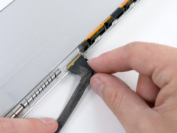

  30. MacBook Pro 17" Unibody Rear Display Bezel Replacement: crwdns2935265:030crwdnd2935265:01crwdnd2935265:02crwdne2935265:0 MacBook Pro 17" Unibody Rear Display Bezel Replacement: crwdns2935265:030crwdnd2935265:02crwdnd2935265:02crwdne2935265:0
    • Carefully guide the LCD cable through the slot in the rear display bezel.
    • You may need to rotate the display slightly to get the cable through.
  31. MacBook Pro 17" Unibody Rear Display Bezel Replacement: crwdns2935265:031crwdnd2935265:01crwdnd2935265:02crwdne2935265:0 MacBook Pro 17" Unibody Rear Display Bezel Replacement: crwdns2935265:031crwdnd2935265:02crwdnd2935265:02crwdne2935265:0
    • Flip the LCD over and lay it face down, being careful to not put too much stress on the display cable.
    • Peel the piece of tape covering the display data cable connector away from the edge closest to the LCD.
  32. MacBook Pro 17" Unibody Rear Display Bezel Replacement: crwdns2935265:032crwdnd2935265:01crwdnd2935265:02crwdne2935265:0 MacBook Pro 17" Unibody Rear Display Bezel Replacement: crwdns2935265:032crwdnd2935265:02crwdnd2935265:02crwdne2935265:0
    • Use the tip of a spudger to flip up the thin steel retaining clip securing the display data cable to its socket on the LCD.
    • Pull the display data cable straight away from its socket on the LCD.
    • Lift the LCD out of the display assembly and set it aside.

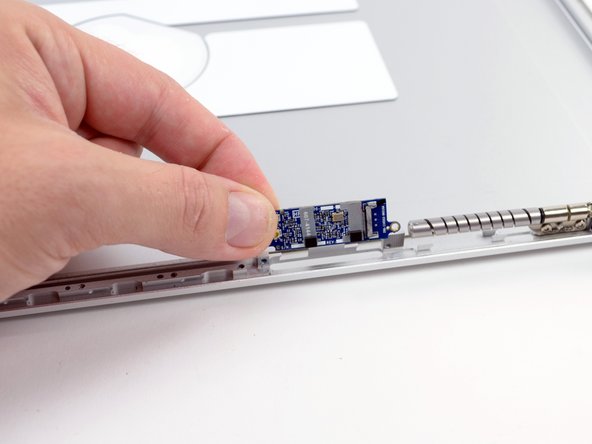

  33. MacBook Pro 17" Unibody Rear Display Bezel Replacement, Camera Board: crwdns2935265:033crwdnd2935265:01crwdnd2935265:01crwdne2935265:0
    • Pull the camera/AirPort cable straight out of its socket on the camera board.
  34. MacBook Pro 17" Unibody Rear Display Bezel Replacement, Camera/AirPort Cable: crwdns2935265:034crwdnd2935265:01crwdnd2935265:01crwdne2935265:0
    • Remove the 2.7 mm Phillips #00 screw securing the AirPort board bracket to the rear display bezel.
  35. MacBook Pro 17" Unibody Rear Display Bezel Replacement: crwdns2935265:035crwdnd2935265:01crwdnd2935265:02crwdne2935265:0 MacBook Pro 17" Unibody Rear Display Bezel Replacement: crwdns2935265:035crwdnd2935265:02crwdnd2935265:02crwdne2935265:0
    • Move the AirPort board bracket towards the bottom of the display case with the tip of a spudger so that it does not block the AirPort board cable.
    • Use the tip of a spudger to disconnect the AirPort board cable by rocking it back and forth until it is free.
  36. MacBook Pro 17" Unibody Rear Display Bezel Replacement: crwdns2935265:036crwdnd2935265:01crwdnd2935265:01crwdne2935265:0
    • Once the cable is disconnected, remove the plastic bracket from the rear display bezel.
  37. MacBook Pro 17" Unibody Rear Display Bezel Replacement: crwdns2935265:037crwdnd2935265:01crwdnd2935265:01crwdne2935265:0
    • Remove the single 1.9 mm Phillips #00 camera cable screw.
  38. MacBook Pro 17" Unibody Rear Display Bezel Replacement: crwdns2935265:038crwdnd2935265:01crwdnd2935265:02crwdne2935265:0 MacBook Pro 17" Unibody Rear Display Bezel Replacement: crwdns2935265:038crwdnd2935265:02crwdnd2935265:02crwdne2935265:0
    • De-route the camera/AirPort cable from the display housing.
    • Carefully pull the camera/AirPort cable through the slot in the aluminum housing underneath the right display hinge.
  39. MacBook Pro 17" Unibody Rear Display Bezel Replacement, Rear Display Bezel: crwdns2935265:039crwdnd2935265:01crwdnd2935265:02crwdne2935265:0 MacBook Pro 17" Unibody Rear Display Bezel Replacement, Rear Display Bezel: crwdns2935265:039crwdnd2935265:02crwdnd2935265:02crwdne2935265:0
    • Carefully pull the display cable through its slot in the aluminum housing, rotating it as necessary to fit through the opening.

  42. MacBook Pro 17" Unibody Rear Display Bezel Replacement: crwdns2935265:042crwdnd2935265:01crwdnd2935265:02crwdne2935265:0 MacBook Pro 17" Unibody Rear Display Bezel Replacement: crwdns2935265:042crwdnd2935265:02crwdnd2935265:02crwdne2935265:0
    • Remove the two 3.1 mm Phillips #00 screws securing the AirPort board to the rear display bezel.
    • Lift and remove the AirPort board from the rear display bezel.

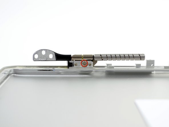

  43. MacBook Pro 17" Unibody Rear Display Bezel Replacement: crwdns2935265:043crwdnd2935265:01crwdnd2935265:02crwdne2935265:0 MacBook Pro 17" Unibody Rear Display Bezel Replacement: crwdns2935265:043crwdnd2935265:02crwdnd2935265:02crwdne2935265:0
    • Remove the three 5.2 mm T6 Torx screws securing the right clutch hinge to the rear display bezel.

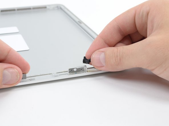

  44. MacBook Pro 17" Unibody Rear Display Bezel Replacement: crwdns2935265:044crwdnd2935265:01crwdnd2935265:02crwdne2935265:0 MacBook Pro 17" Unibody Rear Display Bezel Replacement: crwdns2935265:044crwdnd2935265:02crwdnd2935265:02crwdne2935265:0
    • Lift and remove the right clutch hinge from the rear display bezel.
    • Remove the plastic hinge guard as well, making sure to not lose it.

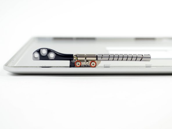

  45. MacBook Pro 17" Unibody Rear Display Bezel Replacement: crwdns2935265:045crwdnd2935265:01crwdnd2935265:02crwdne2935265:0 MacBook Pro 17" Unibody Rear Display Bezel Replacement: crwdns2935265:045crwdnd2935265:02crwdnd2935265:02crwdne2935265:0
    • Remove the three 5.2 mm T6 Torx screws securing the left clutch hinge to the rear display bezel.

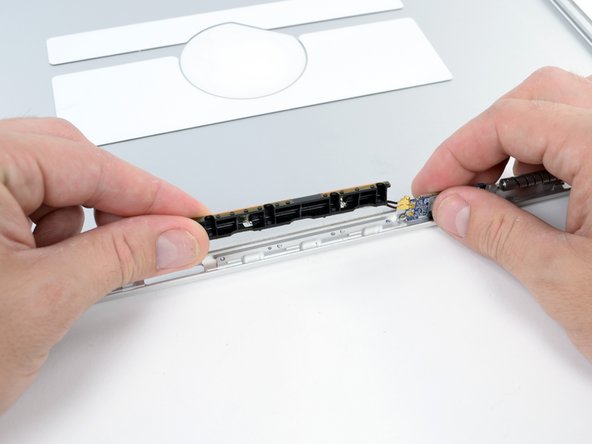

  46. MacBook Pro 17" Unibody Rear Display Bezel Replacement: crwdns2935265:046crwdnd2935265:01crwdnd2935265:01crwdne2935265:0
    • Lift and remove the left clutch hinge from the rear display bezel.
  47. MacBook Pro 17" Unibody Rear Display Bezel Replacement: crwdns2935265:047crwdnd2935265:01crwdnd2935265:01crwdne2935265:0
    • The rear display bezel remains.
