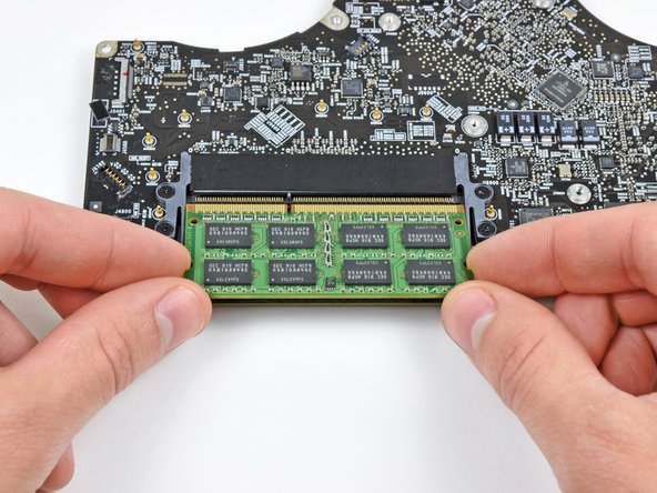

    4. MacBook Pro 17" Unibody Logic Board Replacement: crwdns2935265:030crwdnd2935265:01crwdnd2935265:02crwdne2935265:0 MacBook Pro 17" Unibody Logic Board Replacement: crwdns2935265:030crwdnd2935265:02crwdnd2935265:02crwdne2935265:0
      • Release the tabs on each side of the RAM chip by simultaneously pushing each tab away from the RAM.
      • These tabs lock the chip in place and releasing them will cause the chip to "pop" up.
      • After the RAM chip has popped up, pull it straight out of its socket.
      • Repeat this process if a second RAM chip is installed.
      • Logic board remains.
