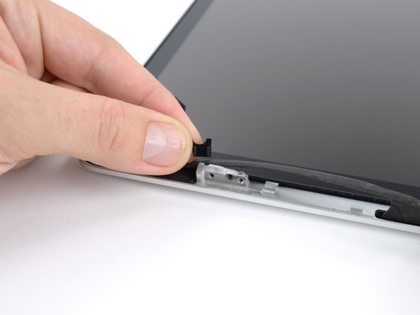

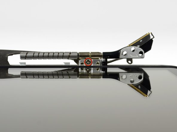

  19. MacBook Pro 17" Unibody Left Clutch Hinge Replacement, Left Clutch Hinge: crwdns2935265:019crwdnd2935265:01crwdnd2935265:02crwdne2935265:0 MacBook Pro 17" Unibody Left Clutch Hinge Replacement, Left Clutch Hinge: crwdns2935265:019crwdnd2935265:02crwdnd2935265:02crwdne2935265:0
    • Remove the three 5.2 mm T6 Torx screws securing the left clutch hinge to the display assembly.
  20. MacBook Pro 17" Unibody Left Clutch Hinge Replacement: crwdns2935265:020crwdnd2935265:01crwdnd2935265:02crwdne2935265:0 MacBook Pro 17" Unibody Left Clutch Hinge Replacement: crwdns2935265:020crwdnd2935265:02crwdnd2935265:02crwdne2935265:0
    • Remove the left clutch hinge from the display assembly.
    • Remove the plastic hinge guard as well, making sure to not lose it.
