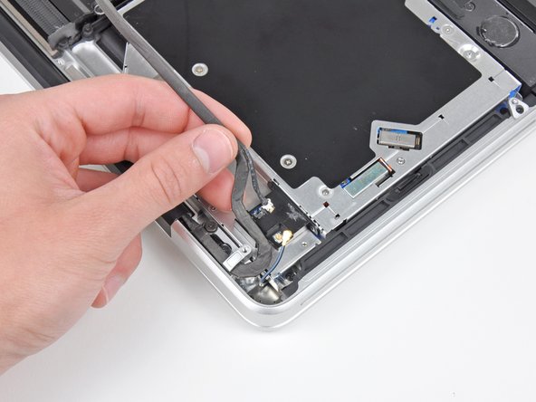

  6. MacBook Pro 17" Unibody LCD Replacement: crwdns2935265:06crwdnd2935265:01crwdnd2935265:01crwdne2935265:0
    • Carefully pull the Bluetooth cable toward the fans to disconnect it from the Bluetooth board.
    • Pull the cable parallel to the face of the optical drive.

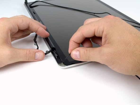

  17. MacBook Pro 17" Unibody LCD Replacement, Front Display Glass: crwdns2935265:017crwdnd2935265:01crwdnd2935265:03crwdne2935265:0 MacBook Pro 17" Unibody LCD Replacement, Front Display Glass: crwdns2935265:017crwdnd2935265:02crwdnd2935265:03crwdne2935265:0 MacBook Pro 17" Unibody LCD Replacement, Front Display Glass: crwdns2935265:017crwdnd2935265:03crwdnd2935265:03crwdne2935265:0
    • It's very easy for the rubber display gasket to deform when exposed to heat, so it is best to remove it before using a heat gun to remove the display glass.
    • Insert a plastic opening tool underneath the black rubber gasket at the bottom left corner of the display assembly.
    • Gently pry the wide edge of the gasket up from the back case.

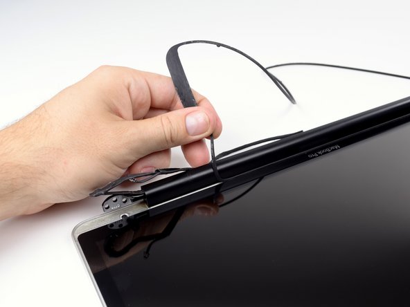

  18. MacBook Pro 17" Unibody LCD Replacement: crwdns2935265:018crwdnd2935265:01crwdnd2935265:02crwdne2935265:0 MacBook Pro 17" Unibody LCD Replacement: crwdns2935265:018crwdnd2935265:02crwdnd2935265:02crwdne2935265:0
    • Starting with the freed corner, pull the left gasket off the left side of the display assembly.
  19. MacBook Pro 17" Unibody LCD Replacement: crwdns2935265:019crwdnd2935265:01crwdnd2935265:02crwdne2935265:0 MacBook Pro 17" Unibody LCD Replacement: crwdns2935265:019crwdnd2935265:02crwdnd2935265:02crwdne2935265:0

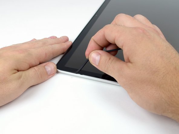

    • With the panel sufficiently heated, fasten a heavy-duty suction cup near the lower right corner of the display glass.
    • To attach the suction cups we sell, first position the suction cup with the movable handle parallel to the face of the glass panel. While lightly holding the suction cup against the glass, raise the movable handle until it is parallel with the other handle.
    • Gently lift the corner of the display glass enough to insert a guitar pick between it and the display assembly.
    • Use the guitar pick to gently pry up the adhesive securing the front glass to the display.
    • Pry up the glass panel along the right edge of the display up to the halfway point.
    • Leave the guitar pick in place halfway up the right side of the display and remove the suction cup.

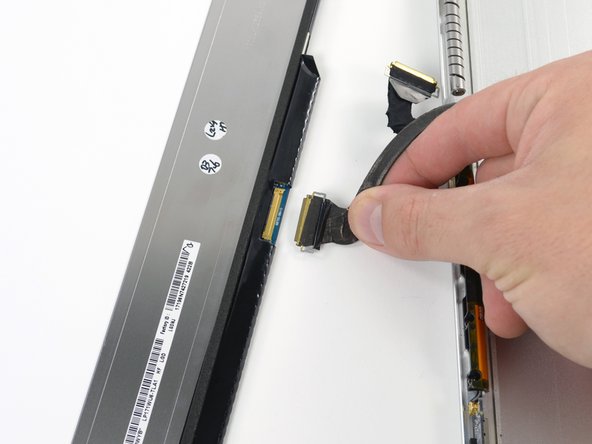

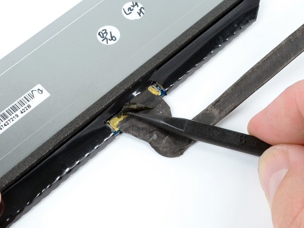

  33. MacBook Pro 17" Unibody LCD Replacement: crwdns2935265:033crwdnd2935265:01crwdnd2935265:02crwdne2935265:0 MacBook Pro 17" Unibody LCD Replacement: crwdns2935265:033crwdnd2935265:02crwdnd2935265:02crwdne2935265:0
    • Flip the LCD over and lay it face down, being careful to not put too much stress on the display cable.
    • Peel the piece of tape covering the display data cable connector away from the edge closest to the LCD.
  34. MacBook Pro 17" Unibody LCD Replacement: crwdns2935265:034crwdnd2935265:01crwdnd2935265:02crwdne2935265:0 MacBook Pro 17" Unibody LCD Replacement: crwdns2935265:034crwdnd2935265:02crwdnd2935265:02crwdne2935265:0
    • Use the tip of a spudger to flip up the thin steel retaining clip securing the display data cable to its socket on the LCD.
    • Pull the display data cable straight away from its socket on the LCD.
    • Lift the LCD out of the display assembly and set it aside.
