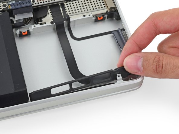

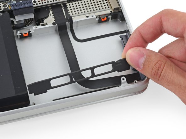

  8. MacBook Pro 17" Unibody Hard Drive Bracket Replacement, Hard Drive Bracket: crwdns2935265:08crwdnd2935265:01crwdnd2935265:01crwdne2935265:0
    • Remove the two 5 mm Phillips #00 screws securing the hard drive bracket to the upper case.
  9. MacBook Pro 17" Unibody Hard Drive Bracket Replacement: crwdns2935265:09crwdnd2935265:01crwdnd2935265:03crwdne2935265:0 MacBook Pro 17" Unibody Hard Drive Bracket Replacement: crwdns2935265:09crwdnd2935265:02crwdnd2935265:03crwdne2935265:0 MacBook Pro 17" Unibody Hard Drive Bracket Replacement: crwdns2935265:09crwdnd2935265:03crwdnd2935265:03crwdne2935265:0
    • Tilt the outer hard drive bracket up toward the logic board and remove it from the rear case.
