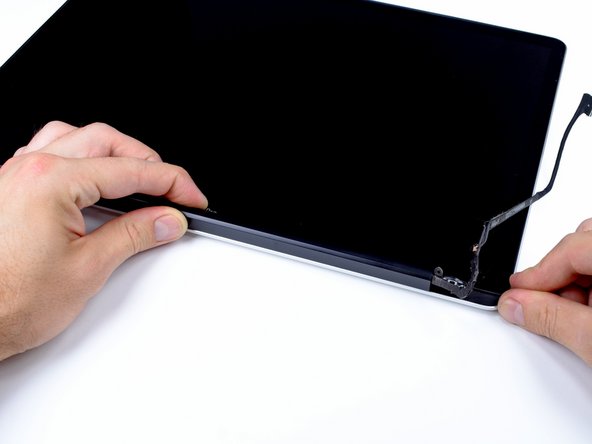

  17. MacBook Pro 17" Unibody Clutch Cover Replacement, Clutch Cover: crwdns2935265:017crwdnd2935265:01crwdnd2935265:02crwdne2935265:0 MacBook Pro 17" Unibody Clutch Cover Replacement, Clutch Cover: crwdns2935265:017crwdnd2935265:02crwdnd2935265:02crwdne2935265:0
    • Grab the clutch cover as shown and slide it toward the right side of the display.
    • It should move about 1/4" and stop. Don't force it beyond this point.
  18. MacBook Pro 17" Unibody Clutch Cover Replacement: crwdns2935265:018crwdnd2935265:01crwdnd2935265:02crwdne2935265:0 MacBook Pro 17" Unibody Clutch Cover Replacement: crwdns2935265:018crwdnd2935265:02crwdnd2935265:02crwdne2935265:0
    • Lifting the left edge of the clutch cover, gently rock it back and forth on its long axis while pulling it away from the display.
    • Remove the clutch cover from the display, minding any cables that may get caught.
