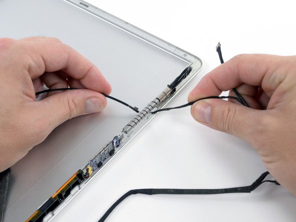

  35. MacBook Pro 17" Unibody Camera/AirPort Cable Replacement, Camera Board Assembly: crwdns2935265:035crwdnd2935265:01crwdnd2935265:01crwdne2935265:0
    • Remove the two 2.7 mm Phillips #00 screws securing the camera board to the rear display bezel.
  36. MacBook Pro 17" Unibody Camera/AirPort Cable Replacement: crwdns2935265:036crwdnd2935265:01crwdnd2935265:01crwdne2935265:0
    • Lift and remove the camera assembly out of the rear display bezel.
  37. MacBook Pro 17" Unibody Camera/AirPort Cable Replacement, Camera Board: crwdns2935265:037crwdnd2935265:01crwdnd2935265:01crwdne2935265:0
    • Pull the camera/AirPort cable straight out of its socket on the camera board.
  38. MacBook Pro 17" Unibody Camera/AirPort Cable Replacement, Camera/AirPort Cable: crwdns2935265:038crwdnd2935265:01crwdnd2935265:01crwdne2935265:0
    • Remove the 2.7 mm Phillips #00 screw securing the AirPort board bracket to the rear display bezel.

  41. MacBook Pro 17" Unibody Camera/AirPort Cable Replacement: crwdns2935265:041crwdnd2935265:01crwdnd2935265:01crwdne2935265:0
    • Remove the single 1.9 mm Phillips #00 camera cable screw.
  42. MacBook Pro 17" Unibody Camera/AirPort Cable Replacement: crwdns2935265:042crwdnd2935265:01crwdnd2935265:02crwdne2935265:0 MacBook Pro 17" Unibody Camera/AirPort Cable Replacement: crwdns2935265:042crwdnd2935265:02crwdnd2935265:02crwdne2935265:0
    • De-route the camera/AirPort cable from the display housing.
    • Carefully pull the camera/AirPort cable through the slot in the aluminum housing underneath the right display hinge.
