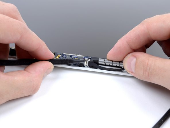

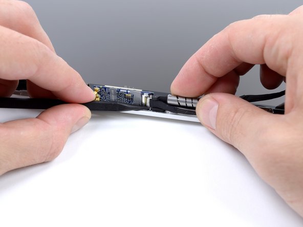

  19. MacBook Pro 17" Unibody AirPort Board Replacement, AirPort Board: crwdns2935265:019crwdnd2935265:01crwdnd2935265:01crwdne2935265:0
    • Use the tip of a spudger to disconnect the two antenna cable connectors from the AirPort board.
  20. MacBook Pro 17" Unibody AirPort Board Replacement: crwdns2935265:020crwdnd2935265:01crwdnd2935265:01crwdne2935265:0
    • Remove the single 2.7 mm Phillips #00 screw securing the AirPort board bracket to the display case.
  21. MacBook Pro 17" Unibody AirPort Board Replacement: crwdns2935265:021crwdnd2935265:01crwdnd2935265:03crwdne2935265:0 MacBook Pro 17" Unibody AirPort Board Replacement: crwdns2935265:021crwdnd2935265:02crwdnd2935265:03crwdne2935265:0 MacBook Pro 17" Unibody AirPort Board Replacement: crwdns2935265:021crwdnd2935265:03crwdnd2935265:03crwdne2935265:0
    • Move the AirPort board bracket towards the bottom of the display case with the tip of a spudger so that it does not block the AirPort board cable.
    • Use the tip of a spudger to disconnect the AirPort board cable by rocking it back and forth until it is free.
