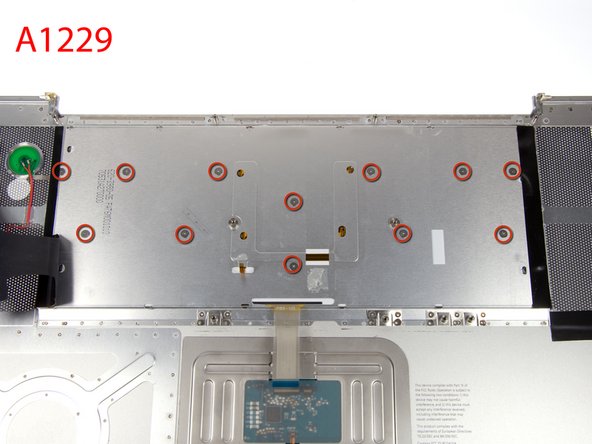

  19. MacBook Pro 17" Models A1151 A1212 A1229 and A1261 Upper Case Replacement: crwdns2935265:019crwdnd2935265:01crwdnd2935265:02crwdne2935265:0 MacBook Pro 17" Models A1151 A1212 A1229 and A1261 Upper Case Replacement: crwdns2935265:019crwdnd2935265:02crwdnd2935265:02crwdne2935265:0
    • If you have a MacBook Pro 17" Model A1151 or A1212, refer to the first picture to remove the ten identical Phillips screws attaching the keyboard to the casing.
    • If you have a MacBook Pro 17" Model A1229, refer to the second picture to remove the twelve identical Phillips screws attaching the keyboard to the casing.

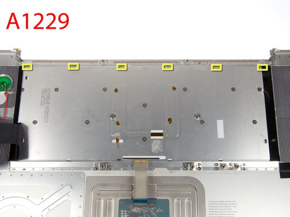

  20. MacBook Pro 17" Models A1151 A1212 A1229 and A1261 Upper Case Replacement: crwdns2935265:020crwdnd2935265:01crwdnd2935265:02crwdne2935265:0 MacBook Pro 17" Models A1151 A1212 A1229 and A1261 Upper Case Replacement: crwdns2935265:020crwdnd2935265:02crwdnd2935265:02crwdne2935265:0
    • If you have a MacBook Pro 17" Model A1151 or A1212, refer to the first picture. There are four locking tabs along the back edge of the keyboard holding it in place. These tabs must be straightened before you can remove the keyboard.
    • If you have a MacBook Pro 17" Model A1229, refer to the first picture. There are six locking tabs along the back edge of the keyboard holding it in place. These tabs must be straightened before you can remove the keyboard.
