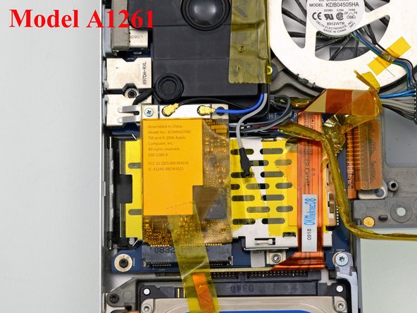

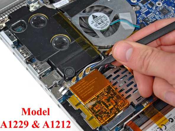

    • Disconnect the two antenna cables attached to the AirPort Extreme card.
    • The cable with the gray shielding attaches to the left side connector, while the cable with the white shielding attaches to the right side.
    • If you have a MacBook Pro 17" Model A1229 or A1212, there are three antenna cables attached to the AirPort Extreme card instead of two.
    • If you have a MacBook Pro 17” Model A1261 the cable with the black shielding attaches to the left side of the connector, while the cable with blue shielding attaches to the right side.

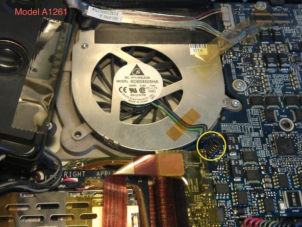

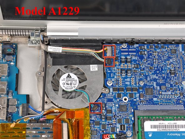

    • Disconnect the iSight, inverter, and left fan cables from the left side of the logic board.
    • Take care not to dislodge the EMI gasket on the silver iSight connector.
    • If you have a MacBook Pro 17" Model A1229, the iSight, inverter, and left fan cables have different composures and locations.
    • For model A1261, the fan cable is located in the same location as the model A1229, 5 o'clock to the fan. The iSight and inverter can remain connected. Lift the tape from the top of the fan and make sure to check the connections afterward.

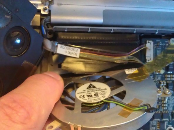

    • Lift the left fan and its metal bracket out of the computer.
    • The tape that covers the top of the fan can be reused if the fan is removed carefully. Pivot the fan towards the screen and very slowly pull bottom of the fan away from the tape from left to right. It should peel off without stretching if done slowly. Then slide the new fan under the tape and press the tape back on the top of the fan.
