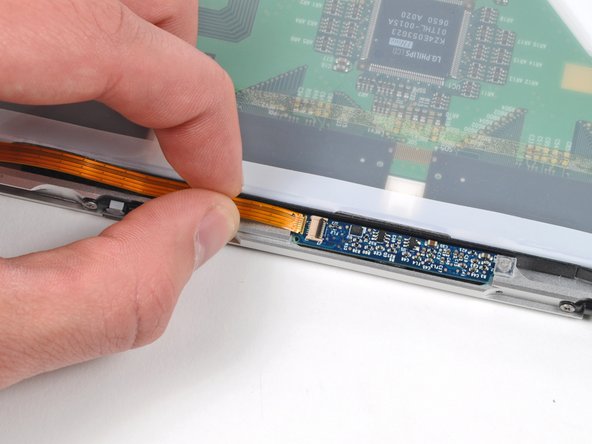

  33. MacBook Pro 17" Models A1151 A1212 A1229 and A1261 Left Clutch Hinge Replacement, Inverter/Antenna Cables: crwdns2935265:033crwdnd2935265:01crwdnd2935265:01crwdne2935265:0
    • Remove the three pieces of tape securing the camera cable to the display assembly.
  34. MacBook Pro 17" Models A1151 A1212 A1229 and A1261 Left Clutch Hinge Replacement: crwdns2935265:034crwdnd2935265:01crwdnd2935265:02crwdne2935265:0 MacBook Pro 17" Models A1151 A1212 A1229 and A1261 Left Clutch Hinge Replacement: crwdns2935265:034crwdnd2935265:02crwdnd2935265:02crwdne2935265:0
    • Use the tip of a spudger or your fingernail to flip up the ZIF retaining flap on the camera cable socket at the edge of the camera board near the top center of the front display bezel.
    • Be sure you are prying up on the retaining flap, not the socket itself.
    • Pull the camera cable out of its socket.
  35. MacBook Pro 17" Models A1151 A1212 A1229 and A1261 Left Clutch Hinge Replacement: crwdns2935265:035crwdnd2935265:01crwdnd2935265:01crwdne2935265:0
    • Peel the camera cable off the foam tape along the top edge of the display.

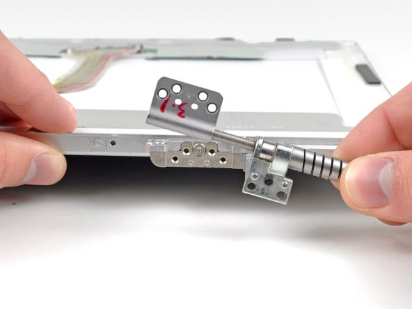

  37. MacBook Pro 17" Models A1151 A1212 A1229 and A1261 Left Clutch Hinge Replacement, Left Clutch Hinge: crwdns2935265:037crwdnd2935265:01crwdnd2935265:02crwdne2935265:0 MacBook Pro 17" Models A1151 A1212 A1229 and A1261 Left Clutch Hinge Replacement, Left Clutch Hinge: crwdns2935265:037crwdnd2935265:02crwdnd2935265:02crwdne2935265:0
    • Remove the four 3.5 mm T6 Torx screws securing the left clutch hinge to the front display bezel.
    • Remove the left clutch hinge from the front display bezel.
