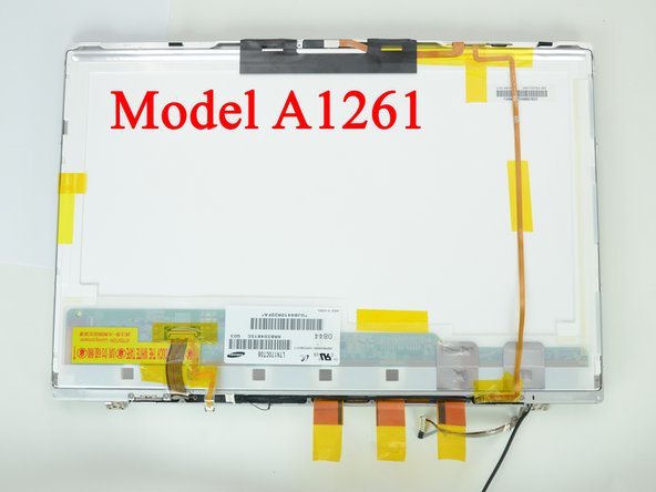

  20. MacBook Pro 17" Models A1151 A1212 A1229 and A1261 Clutch Cover Replacement: crwdns2935265:020crwdnd2935265:01crwdnd2935265:01crwdne2935265:0
    • Slightly lift the lower edge of the display and pull it away from the rear display bezel.
    • The rear display bezel remains.

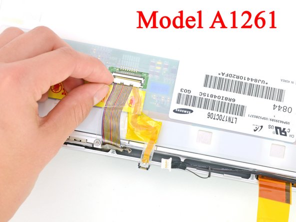

    • Remove the two pieces of tape securing the display data cable to the LCD.
  28. MacBook Pro 17" Models A1151 A1212 A1229 and A1261 Clutch Cover Replacement: crwdns2935265:028crwdnd2935265:01crwdnd2935265:02crwdne2935265:0 MacBook Pro 17" Models A1151 A1212 A1229 and A1261 Clutch Cover Replacement: crwdns2935265:028crwdnd2935265:02crwdnd2935265:02crwdne2935265:0
    • Disconnect the display data cable from the LCD by pulling it toward the bottom edge of the display.
  29. MacBook Pro 17" Models A1151 A1212 A1229 and A1261 Clutch Cover Replacement: crwdns2935265:029crwdnd2935265:01crwdnd2935265:01crwdne2935265:0
    • Move the display data cable out of the way to remove the Phillips screw hidden underneath.

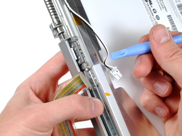

    • While pulling the clutch assembly away from the clutch hinge with one hand, insert an iPod opening tool between the clutch cover and the front display bezel to lift the clutch cover over the retaining pin on the front display bezel.
    • Pull the clutch assembly away from the front display bezel.
  31. MacBook Pro 17" Models A1151 A1212 A1229 and A1261 Clutch Cover Replacement: crwdns2935265:031crwdnd2935265:01crwdnd2935265:01crwdne2935265:0
    • Repeat the process covered in the previous step to free the other side of the clutch assembly from the front display bezel.
  32. MacBook Pro 17" Models A1151 A1212 A1229 and A1261 Clutch Cover Replacement: crwdns2935265:032crwdnd2935265:01crwdnd2935265:01crwdne2935265:0
    • Remove the clutch assembly from the front display bezel, minding any cables that may get caught.
