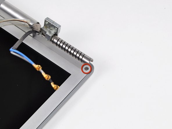

    • The hinge end caps on this model can be easily removed at this point, as they are not fastened to the hinge and may fall off during service.
    • Remove the Phillips screws from the lower left and right corners of the display (two screws total).

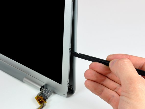

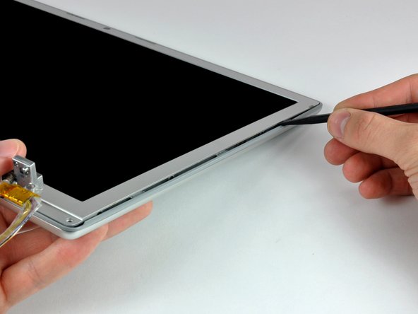

  15. MacBook Pro 17" Models A1151 A1212 A1229 and A1261 Antenna Cover Replacement: crwdns2935265:015crwdnd2935265:01crwdnd2935265:03crwdne2935265:0 MacBook Pro 17" Models A1151 A1212 A1229 and A1261 Antenna Cover Replacement: crwdns2935265:015crwdnd2935265:02crwdnd2935265:03crwdne2935265:0 MacBook Pro 17" Models A1151 A1212 A1229 and A1261 Antenna Cover Replacement: crwdns2935265:015crwdnd2935265:03crwdnd2935265:03crwdne2935265:0
    • Insert the flat end of a spudger perpendicular to the face of the display between the plastic strip attached to the rear bezel and the front bezel.
    • Do not insert your spudger between the plastic strip and the rear bezel.
    • With the spudger still inserted, rotate it away from the display to separate the front and rear bezels.
    • Work along the right edge of the display until the rear bezel is evenly separated from the front bezel.

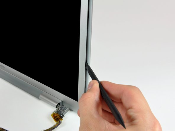

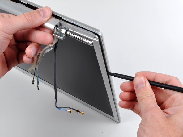

  16. MacBook Pro 17" Models A1151 A1212 A1229 and A1261 Antenna Cover Replacement: crwdns2935265:016crwdnd2935265:01crwdnd2935265:02crwdne2935265:0 MacBook Pro 17" Models A1151 A1212 A1229 and A1261 Antenna Cover Replacement: crwdns2935265:016crwdnd2935265:02crwdnd2935265:02crwdne2935265:0
    • Insert your spudger between the front and rear display bezels at the lower right corner of the display.
    • Pry the rear bezel away from the front bezel to slightly separate the bottom edge of the rear display bezel.

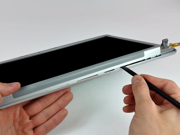

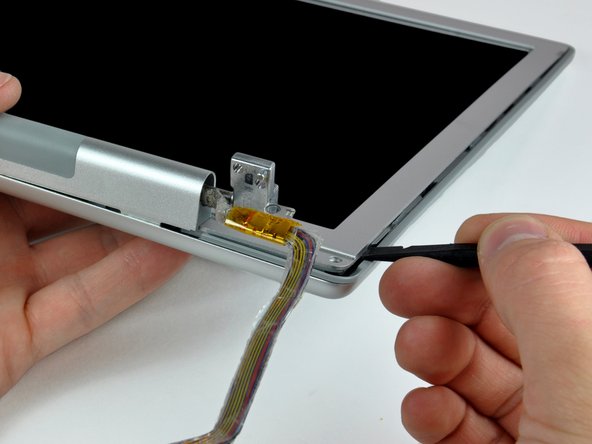

  17. MacBook Pro 17" Models A1151 A1212 A1229 and A1261 Antenna Cover Replacement: crwdns2935265:017crwdnd2935265:01crwdnd2935265:02crwdne2935265:0 MacBook Pro 17" Models A1151 A1212 A1229 and A1261 Antenna Cover Replacement: crwdns2935265:017crwdnd2935265:02crwdnd2935265:02crwdne2935265:0
    • Insert the flat end of a spudger into the gap between the rear display bezel and the clutch cover.
    • Twist the spudger to separate the lower edge of the rear display bezel from the clutch cover.
    • Work along the lower edge of the rear bezel until it is evenly separated from the clutch cover.

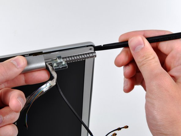

  18. MacBook Pro 17" Models A1151 A1212 A1229 and A1261 Antenna Cover Replacement: crwdns2935265:018crwdnd2935265:01crwdnd2935265:03crwdne2935265:0 MacBook Pro 17" Models A1151 A1212 A1229 and A1261 Antenna Cover Replacement: crwdns2935265:018crwdnd2935265:02crwdnd2935265:03crwdne2935265:0 MacBook Pro 17" Models A1151 A1212 A1229 and A1261 Antenna Cover Replacement: crwdns2935265:018crwdnd2935265:03crwdnd2935265:03crwdne2935265:0
    • Now that the right and bottom edges of the rear bezel are slightly separated from the front bezel, use a spudger to pop the rear bezel off the tabs near the lower right corner of the display.
  19. MacBook Pro 17" Models A1151 A1212 A1229 and A1261 Antenna Cover Replacement: crwdns2935265:019crwdnd2935265:01crwdnd2935265:03crwdne2935265:0 MacBook Pro 17" Models A1151 A1212 A1229 and A1261 Antenna Cover Replacement: crwdns2935265:019crwdnd2935265:02crwdnd2935265:03crwdne2935265:0 MacBook Pro 17" Models A1151 A1212 A1229 and A1261 Antenna Cover Replacement: crwdns2935265:019crwdnd2935265:03crwdnd2935265:03crwdne2935265:0

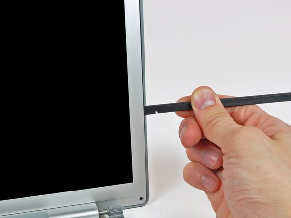

    • Insert the flat end of a spudger between the front bezel and the plastic strip attached to the rear bezel near the screw holes at the bottom corners of the display.
    • Rotate your spudger toward the rear bezel to separate it from the front bezel.
    • If necessary, continue separating the left edge of the rear bezel off the tabs on the front display bezel.

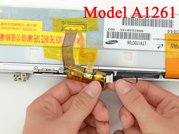

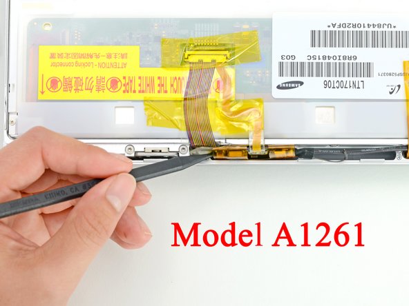

  22. MacBook Pro 17" Models A1151 A1212 A1229 and A1261 Antenna Cover Replacement: crwdns2935265:022crwdnd2935265:01crwdnd2935265:03crwdne2935265:0 MacBook Pro 17" Models A1151 A1212 A1229 and A1261 Antenna Cover Replacement: crwdns2935265:022crwdnd2935265:02crwdnd2935265:03crwdne2935265:0 MacBook Pro 17" Models A1151 A1212 A1229 and A1261 Antenna Cover Replacement: crwdns2935265:022crwdnd2935265:03crwdnd2935265:03crwdne2935265:0
    • Carefully lift the inverter out of the clutch cover.
  23. MacBook Pro 17" Models A1151 A1212 A1229 and A1261 Antenna Cover Replacement: crwdns2935265:023crwdnd2935265:01crwdnd2935265:02crwdne2935265:0 MacBook Pro 17" Models A1151 A1212 A1229 and A1261 Antenna Cover Replacement: crwdns2935265:023crwdnd2935265:02crwdnd2935265:02crwdne2935265:0
    • Disconnect the inverter cable by pulling its connector away from the socket on the inverter board.

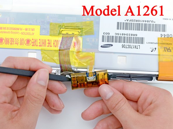

  24. MacBook Pro 17" Models A1151 A1212 A1229 and A1261 Antenna Cover Replacement: crwdns2935265:024crwdnd2935265:01crwdnd2935265:02crwdne2935265:0 MacBook Pro 17" Models A1151 A1212 A1229 and A1261 Antenna Cover Replacement: crwdns2935265:024crwdnd2935265:02crwdnd2935265:02crwdne2935265:0
    • Disconnect the backlight connector from the inverter board.
    • Be careful when removing this connector, as it may be firmly seated in its socket.
    • Remove the inverter from the display.
